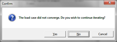

When analyzing a model the following occurs:
Confirm
The load case did not converge. Do you wish to continue iterating?
Yes   No   Cancel
What can be done to avoid this message from appearing?

#1. Press Yes to continue iterating
a: Model does not converge after 5 iteration, should it continue to iterate or not?
b. How to change number of iterations for static analysis?

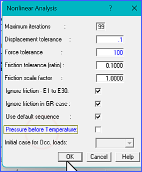

#5. Modify non-linear analysis tolerance settings (i.e. Displacement Tolerance, Force Tolerance, Friction Tolerance (ratio), or Friction Scale Factor).
Suggested tolerances for Victaulic models:
Models with multiple Victaulic fittings seems quite sensitive and exerts a huge amount of forces. One setting that may help in converging an analysis would be to uncheck the Nonlinear Analysis option, "Pressure Before Temperature". Also suggest adjusting the displacement and force tolerances (0.1 in displacement, 100 lbf force tolerance).
