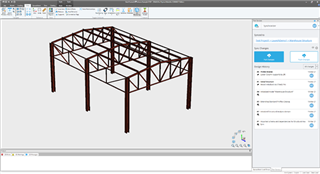

Figure 5 - Synchronizer sidebar listing the changes committed to iModel from STAAD - Structure. Sample Model Warehouse Structure.

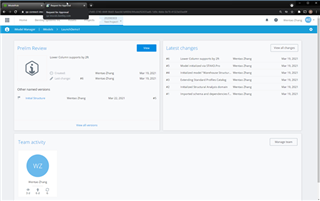

Figure 6 - Display of the Preliminary Named Version of this iModel in iTwinHub
Figure 7 - Changes and Named Versions reflected in iModel Manager

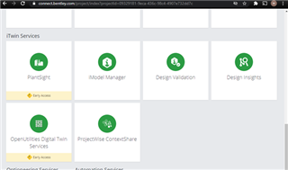

In the web browser, navigate to your Project page (located in the header see Figure 9). Select your Project (Figure 10) and click iModel Manager (Figure 11).
Figure 10 - List of Projects accessible in CONNECT Portal
Figure 11 - List of services of the selected Project. Click iModel Manager

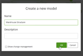

G Click New to create a new model – dialogue would pop up for you to fill in a Model Name and description.

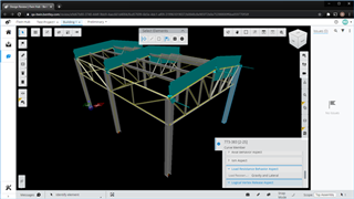

Named Versions of the iModel can be viewed in the browser by clicking the View button (Figure 16).
Figure 17 – The specific Named Version of this iModel is visible in the web browser.
