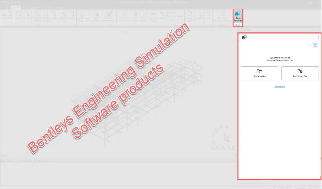

The traditional 4 ISM operations (Create ISM Repository, New from ISM Repository, Update ISM Repository and Update from ISM Repository) have been simplified into 2 (Push or Pull) and standardized into a sidebar experience across participating applications.
To continue, Ensure File mode is toggled on
Figure 1 - iTwin Services Sidebar under File Synchronization mode.
(Optionally) review application specific synchronization settings by clicking  .

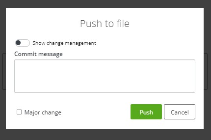

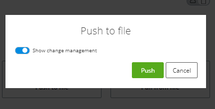

3. Click Push, (optionally) toggle off show change management to see expanded dialog
3.A  Expanded dialoge allows you to enter the commit message, this is a short message that describes the items changed.
4. If Show Change Management is enabled, preview changes in iTwin Analytical Synchronizer before the changes are commited.

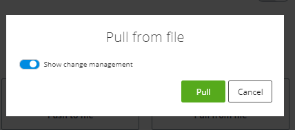

1. Click
2. Click Pull (optionally) toggle off show change management.
3. Button expands into status pane
