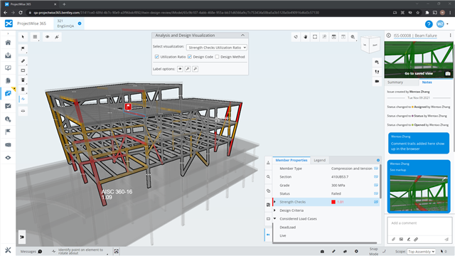

Figure 1 - Design Review in the web browser - Internal view of a steel roof structure with members color coded by design utilization ratio.

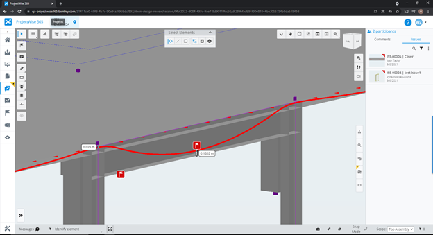

Figure 2 - Cross section view of Post Tension (PT) profile with measurement tool indicating external cover. Issues (Red Flags) are shown in areas of interest for review by the engineer.

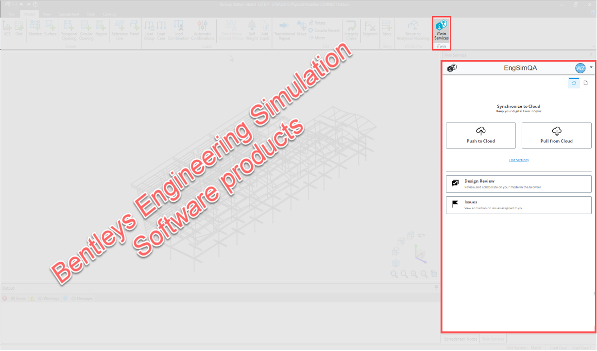

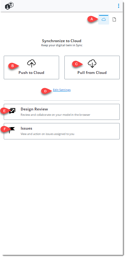

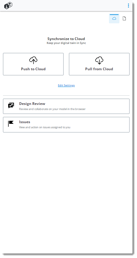

Figure 3 - Sidebar as shown within Bentley's Engineering applications. Users can directly access synchronization to iModels, View iModels in Browser and in-product issues resolution service

  2. Whilst in the browser, review and query Analytical and Design results such as
    1. Post Tension (PT) tolerances
    2. Design utilization ratios including critical design checks
    3. Member profiles and material properties.

Figure 4 - Sidebar user interface legend

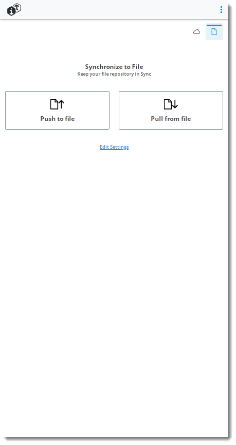

A. Toggle between Cloud/File Synchronization mode. File synchronization formerly known as ISM.
B. Push to Cloud allows you to push your application data to an iModel. For an initial Push, a new model would be created on your behalf. For subsequent push, only the changeset would be submitted for consolidation to the iModel
C. Pull from Cloud allows you to pull in changes from your connected iModel. These changes may come from other project participants using a different application.
D. Settings; Displays application specific settings on how the synchronization would take place. Some common settings such as model offsets are standardized across all applications.
E. Design Review. Click on Design Review to view your iModel in the browser. The iModel in the browser will always reflect the latest changeset in its timeline of change.
F. Click on Issues to view the Issues Resolution Panel.

  1. Have a model in your application of choice handy and click iTwin Services button  within your application (for location of where the iTwin Services button is located in your application see Table 1).
  2. Once the sidebar is loaded, ensure “cloud” mode is toggled on in the top right corner of the sidebar .

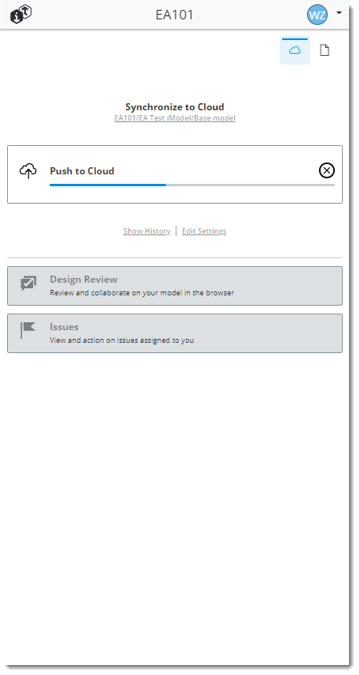

  3. Click “Push to Cloud”.

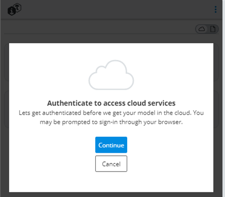

  4. Follow on screen prompt to authenticate. An external web browser may popup to prompt you to sign in and grant access to web services. You would know that you have successfully authenticated when you see your initials in the top right of the sidebar.

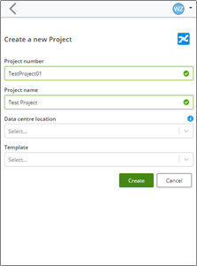

  1. A Digital Connection is a prerequisite to Push/Pull data with an iModel (your Digital Twin in the cloud), view its Change history access Design Review in the browser and in-product Issues Resolution Component
A Digital Connection links your Application data to a PW365 Project or an iModel, both Projects and iModels can be selected or created (by clicking on  ) within the sidebar. Synchronization requires a Digital Conneciton to an iModel whereas issues only require a PW365 Project to be selected.
Once a Project and an iModel is selected. Click confirm to establish Digital Connection.
6. After the Digital Twin Connection is established accept the defaults and click “Sync”.

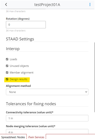

A – Optionally review synchronization settings. This describes HOW objects are translated into the iModel. (For most cases, Okay to leave as default, these settings differ between desktop applications, below image shows STAAD settings for brevity). For STAAD specifically -To get the most out of Analytical Design Review experience - ensure "Design Results" is checked. Having this settings enabled ensures strength check utilization ratios and other design code check details are available in Design Review (in the browser for the reviewer).

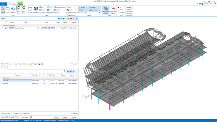

B – Show Change management – Toggling this option on displays iTwin Analytical Synchronizer which compares and displays the “from” model vs “to” model so that you can control the objects and properties to commit to your iModel. This step is optional.

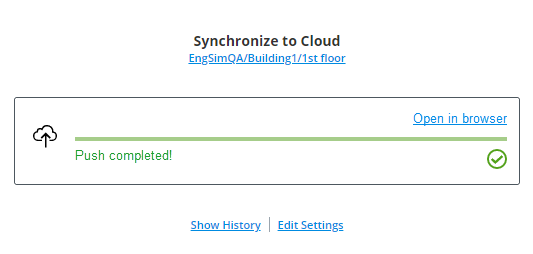

Once the Push is completed – click the “Open in Browser” link to open your iModel containing the latest changeset in the browser. You can also access your iModel in the browser at any time by clicking on Design Review.
