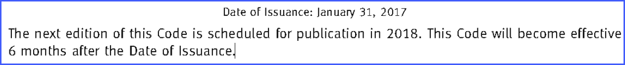

Answer: The most important date is when was the code actually published, do not just consider the code edition year. In most codes (Example ASME B31.3 - 2018) there is a page near the front of the document with copyright information. This page may contain the actually publication date, example - image below from ASME B31.3 - 2018

As mentioned in ASME B31.3 2018, the code will NOT become effective until 6 months after the publication date. Meaning that ASME B31.3 - 2018 will not be in effect until April 2019, but this feature may be already in the program by that date. Furthermore, after being released, some codes are not immediately accepted by industry or governing bodies. It may take months or years before a code is accepted. By that time, another version may have been released.
