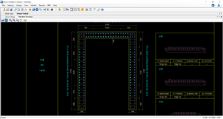

There is option under shear wall for detailing as Boundary Element or Equi Spaced rebar. I wish to have detailing as equi-spaced rebar, but it never gives detailing as equi spaced and redesign consume lot of time
When you select the option of “Detail with Equi-spaced rebar arrangement" RCDC design and detail the wall with Zones, however rebar spacing in all zones are maintain same. refer below snap showing rebar arrangement with same setting,
if you unselect "Detail wall with Boundary element" it will design as a ductile wall without Boundary element but it will try to provide zones to optimized the reinforcement.
when you select both the options i.e. Boundary element and Equi-spaced, it will design as Boundary wall with equi-spaced rebar arrangement. This setting is applicable for Non-ductile wall if you want t provide equal spacing.

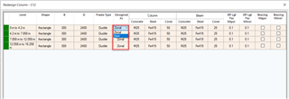

if you want to design wall as column and with same rebar having equal spacing, then you have to perform the redesign step, however in redesign column tool allows user to change the type from "Zonal" to "Equi" in one step for wall along height. refer below snap,
for wall, RCDC tries to optimize the reinforcement by providing higher diameter at edges.
