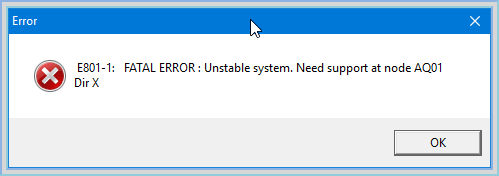

When running an analysis the following occurs:
Error
 E801-1:   FATAL ERROR : Unstable system. Need support at node XXX    Dir XX
OK
Why and how to fix it?

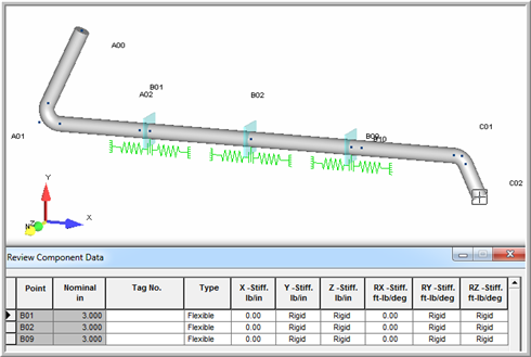

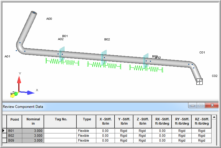

Scenario #3:
With the following model and anchor settings:
Fix:
The problem with the model above is that there are no supports / anchors to stop the entire model from rotating about the X-axis as all the anchors are set with Rx stiffness = 0.00 and a Line Stop support only provides axial restraint. There must be some small resistance in All directions for the analysis to run. In addition, all the line stops have a large gap.
Simply change an anchor to have some small amount of resistance (i.e. 0.10 Ft-lb/deg) for Rx and change 1 line stop to have a 0.00 gap or change 1 anchor X-Stiff setting to a small value (i.e..0.10 lbs/in)

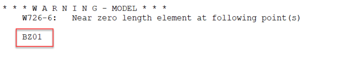

Scenario #6:
The following warning message was found in the Model consistency check Report:
* * * W A R N I N G - MODEL * * *
     W726-6:   Near zero length element at following point(s)
     BZ01
Upon reviewing the model, it was identified that the presence of a zero-length element is the root cause of the error during analysis. Zero-length elements typically occur when two connected nodes occupy the same coordinates or when an element is inadvertently defined without any measurable length. Such elements can lead to instability in the analysis process and generate warnings or errors.
To resolve this issue, it is necessary to delete node BZ01, which is associated with the zero-length element. Removing this node will eliminate the problematic element and allow the system to perform the analysis successfully without generating any error messages.
It is also recommended to review the model for similar inconsistencies to prevent recurrence of this issue in future analyses.

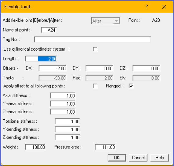

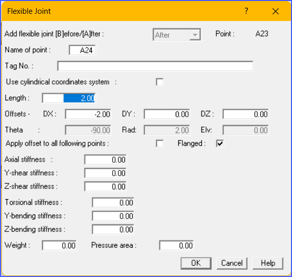

Flexible Joint related issues
Scenario #1:
One or more flexible joints on the same pipe run, where 0.00 stiffness values are used.
FIX:
Instead of using stiffness values of 0.00, enter in a very low stiffness value, example 1.0 (almost any value, avoid 0.00 values).
Example: (random non-0.00 values used)

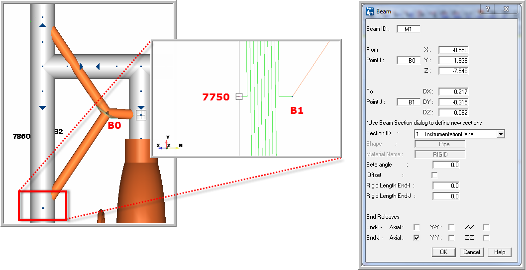

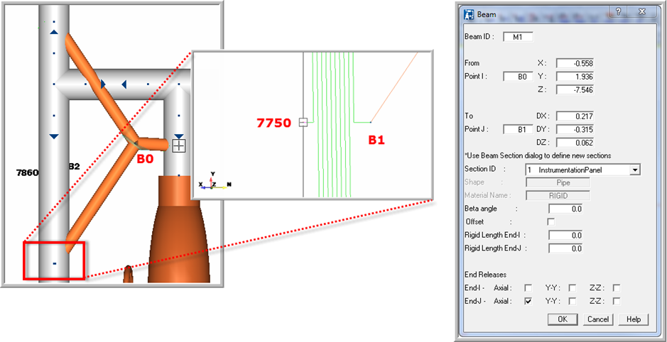

Scenario #1: Beam End release configured:
After importing in the frame model through Pipelink. Error "E801-1: FATAL ERROR: Unstable System. Need support at node XX" is encountered. The AutoPIPE model (without the frame model) runs with no issues. Why does AutoPIPE think the frame model is unsupported when the frame model runs ok in STAAD without issue?
FIX A:
While reviewing the AutoPIPE model, multiple imported beams were found to have their ends released in all direction, (i.e. on a beam dialog screen is the following option "End Releases: End-I/J Axial (translation), Y-Y and Z-Z".
Therefore the beams were able to freely rotate. AutoPIPE requires that all components are restrained to some small degree in at least one direction.
Checked one box for Axial (translation), Y-Y or Z-Z for all beams.
Note: The STAAD model failed when loads were applied, it was also fixed.
FIX B:
End release cannot be assigned to a cantilever beam. As mentioned in AutoPIPE help,
Again, this clear indicates what end release cannot be assigned to a cantilever beam. Choose to disable all Beam End releases configured on a free end, or insert a support, anchor, or another beam to avoid this error message.

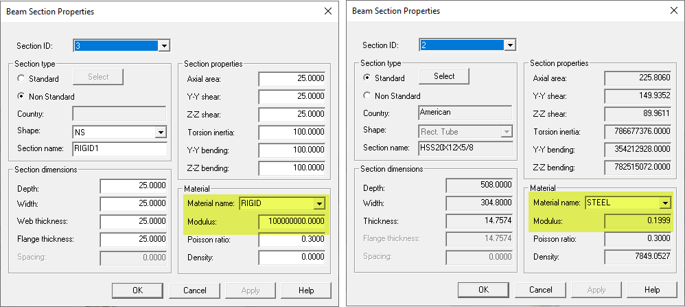

Scenario #5: Verify All Beam ID settings

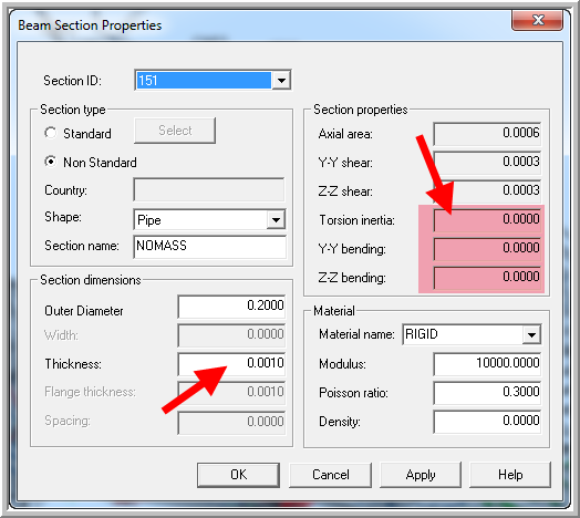

If all the beams in the model have been double checked to confirm connectivity. Check the Beam properties,
a. Some values may be 0.000, as shown below:
Fix:
Option #1: Increase the wall thickness and try to re-analyze the system. This may be an iterative procedure until the analysis is able to run.
Option #2: Review the units used for the setting, if the unit is too larger (ex m^4) resulting in a very small value that is not registered on the dialog, select a different input/output units on the General Model options dialog. If the units file is changed, be sure to go back into each beam definition and reselect the Beam from the library to update the values.
b. Some values may be extremely large, as shown below:
Fix:
The problem seems to be with defining a very high modulus value for the Rigid material defined for the Rigid beams. This value is too high even for a rigid, and when several such high rigidity beams connect on to a point which also has a very low rigidy element connected results in an unstable solution.
Setting the modulus value for the rigid to a more reasonable value (say 1000 times steel modulus = 200 E6 N/mm2) resolves the problem.

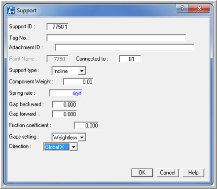

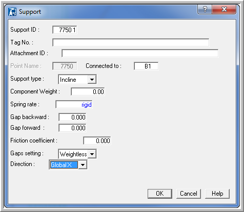

Scenario #6: Beam not attached to a rigid enough node point location
The following is displayed: "E801-1: FATAL ERROR: Unstable System. Need support at node XX"
Fix:
The model Looks ok, however upon closer inspection, the beams are connected between the anchor (B0) and the piping (7750) using Incline supports, shown here:
This would cause the Fatal Error issue, WHY?
Because, after checking the bearing spring direction of an incline support, clearly understand the axial direction between the 2 end points specified on the dialog (ex. 7750 - B1)..
Therefore there is not enough supports resistance on the 6 different global axis to prevent the piping from rotating / moving laterally out of control, ultimately resulting in the Fatal error message being displayed.
Workaround
Insert additional supports as needed to prevent Fatal Error message from being displayed when Analyzing the model
