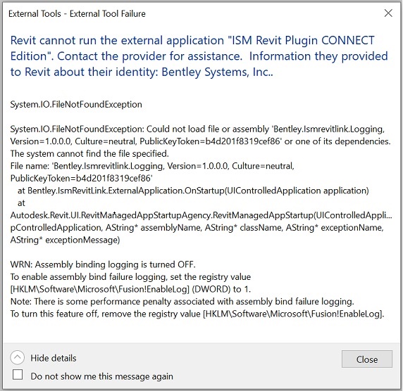

Revit cannot run the external application "ISM Revit Plugin CONNECT Edition"

I am getting the following error when I open Revit. I tried the WRN at the bottom, however I am running into issues trying to set the registry value.
Please uninstall and reinstall ISM Revit Plug-in. Install it with full administrative privileges. While installing stop your firewall and anti-virus software.
