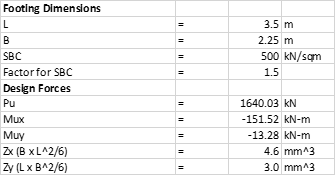

Can you explain the various options available for pressure calculation in RCDC footing design?

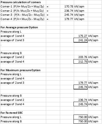

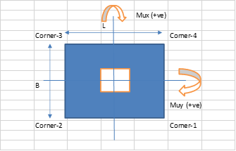

RCDC provides following options to calculate base pressure,
Average Pressure
Maximum Pressure
Factored SBC
Above options are explained below with example:
