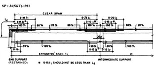

Can you provide clarification regarding the curtailment of 100% top reinforcement at a certain location from column as per IS code?
Reply:
RCDC design the reinforcement as per the forces available at all sections in the beam. It takes 13 stations (i.e. 12 zones) for design of beams. Based on the forces available in each zone, reinforcement is calculated. Lapping locations are available as per user inputs. Default location for lapping of top reinforcement is L/4. As RCDC design the beam for 12 zones, the options of L/3,L/4 and L/6 are available for lapping at top and bottom reinforcement.  User can change the lapping location as per design requirements.
Lapping of top reinforcement is available to optimized the reinforcement. Curtailment location is available in SP 34. Refer below snap,. As far are rebar are lapped with the development length, lapping is permitted for top reinforcement.
RCDC provided various option for top and bottom reinforcement detailing. This option is available in General and reinforcement settings,
If user doesn’t want to provide lapping for top reinforcement, we would suggest you to use Max Dia and Min Dia option of detailing.
