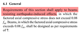

As mentioned in 13920-2016 code, ductility criteria is to be applied to beams which are resisting the Seismic forces. Below image for reference:
As per above sentence all the beams on which seismic forces are applied or the beams that behaves as a part of seismic force resisting system needs to be designed for ductility. But the critical load combination can be any one; which imposes Max Flexure or Max shear on the beam.
So, based on same, when Seismic forces are applied in the analysis file and also when Seismic load cases are selected for design of beams in RCDC, ductility criteria is applied.
Also, there is an option in RCDC where user can select the beams which needs to be designed for Ductility. By default, when ‘Ductile Design’ option is selected from Design settings, RCDC selects all Primary column to column beams to be designed for Ductility criteria.
