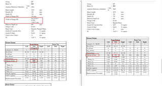

Does STAAD advanced concrete design (RCDC) consider the contributing effects of the slab flanges in RC beam design? I examined the calculation report for some beams and realized  the beams are designed completely as rectangular beams even when you specify them as flange beams.

RCDC can design beams with flanged action (T or L). As per design principles of flanged beam, RCDC uses this action only for mid-span bottom reinforcement.
Effective width of flange-action is calculated as per the provisions in code for simply-supported and continuous beams.
Below snip shows difference where same Beam is designed with Flanged action and without Flanged action, using Indian Code as an example.
