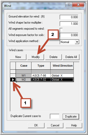

The Load> Wind command enables the user to define static wind load cases (W1 - W10) by generating wind pressure:
Vs. Profile piping height profiles
Per ASCE 7 1998, 2002, 2010, or 2016 code
Per Uniform Building Code (UBC) requirements.

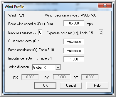

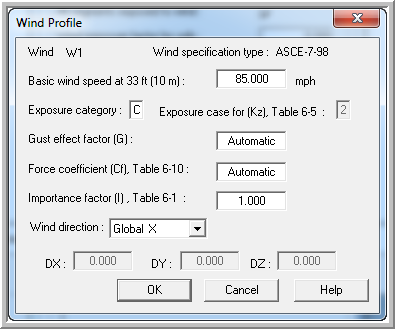

After specifying a new wind load case, select the first cell in the left column to highlight the row and press the Modify button to see more settings for the specified Wind Load Type as indicated below:
The wind force is applied as uniform loads in the local coordinate system of the straight pipe or bend element. The equivalent wind force is assumed to act through the centroid of the element.

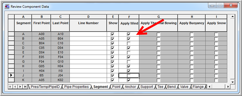

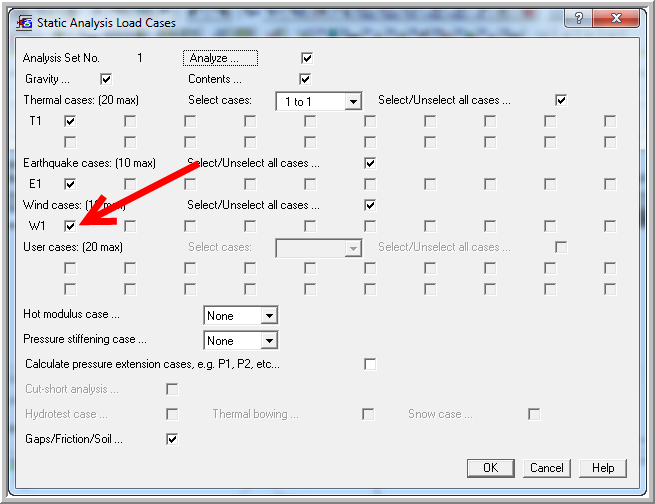

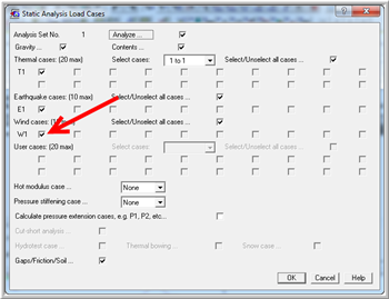

Wind loads will only be applied to piping if both conditions are meet:
1. segments that have "Applied Wind" checked on. I
2. Wind load case must be enabled inside of an analysis set:
Segment Tab on the input grids:
Load> Static Analysis Sets> modify analysis set:

In order to exclude piping inside a building from wind loads, the piping inside should be entered as a separate segment(s) from the piping outside the building.
With the model Input grid opened, select the Segment tab, see column labeled "Apply Wind". Segments with Applied Wind  enabled are considered outside, while segments with Apply disabled are considered inside.
