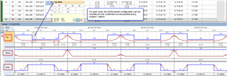

Is there a Customized curtailment provision in RCDC ?
Note that there is an option in RCDC to perform local curtailment by modifying the reinforcement locally for any station of a zone. On the design output window, you can click on the 'Detail' feature and by double click on each zone, you can modify the 'Top reinforcement', 'Bottom reinforcement' & 'Shear reinforcement' also.
Further, in case you want to use the same reinforcement configuration for other zone by avoiding this step, there is further tool available to 'copy reinforcement' & then 'paste reinforcement' to other beam with same size and same material used for design.
Refer the attached video for understanding how this can be done.
