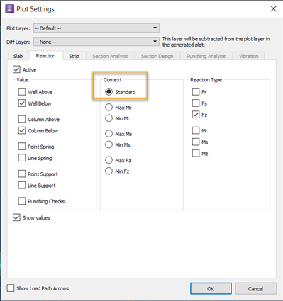

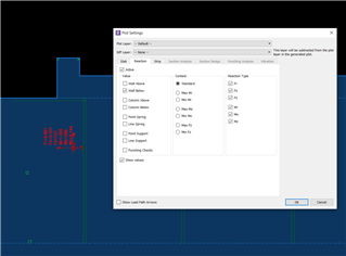

When plotting the results for Wall Reactions the values are not apparent, or are placed away from the walls.
Explanation
There are many places to view wall reactions (or reaction tables). These can be for load cases, combinations or rules sets. The Plot Settings dialog controls which reactions are shown.

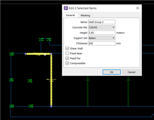

It's now possible, starting in version 8.03, to assign walls to a group by giving them a "Name" property in the Mesh Input - Properties:
When multiple walls are assigned the same name, then the resultant reaction for that group is plotted at the centroid of the group.

If the grouping of wall was unintentional, or no longer desired, edit the wall properties and clear the Name, then remesh and recalculate the model to return to having each wall reaction plotted.
