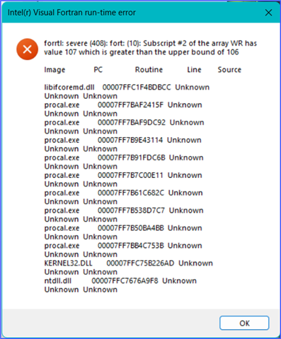

The following may appear when using AutoPIPE Vessel:
Intel(r) Visual Fortran run-time error
forrtl: severe (408): fort: (10): Subscript #2 of the array WR has value 107 which is greater than the upper bound of 106
Image PC Routine Line Source
libifcoremd.dll 00007FFC1F4BDBCC Unknown Unknown Unknown
procal.exe 00007FF7BAF2415F Unknown Unknown Unknown
procal.exe 00007FF7BAF9DC92 Unknown Unknown Unknown
procal.exe 00007FF7B9E43114 Unknown Unknown Unknown
procal.exe 00007FF7B91FDC6B Unknown Unknown Unknown
procal.exe 00007FF7B7C00E11 Unknown Unknown Unknown
procal.exe 00007FF7B61C682C Unknown Unknown Unknown
procal.exe 00007FF7B538D7C7 Unknown Unknown Unknown
procal.exe 00007FF7B50BA4BB Unknown Unknown Unknown
procal.exe 00007FF7BB4C753B Unknown Unknown Unknown
KERNEL32.DLL 00007FFC75B226AD Unknown Unknown Unknown
ntdll.dll 00007FFC7676A9F8 Unknown Unknown Unknown
OK

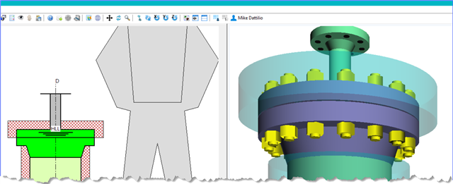

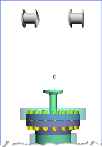

This is has only been reported one time to technical support. In that particular case the model contained a support (lifting accessory - Spreader beam) that was not correctly connected to the vessel. While zoomed into the model the lifting accessory was not visible, and when trying to run the Strength calculation feature the above message appeared.
When zoomed out, easy to see that the lifting accessory was not correctly connected to the vessel.
