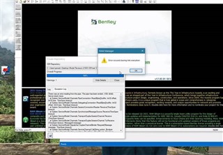

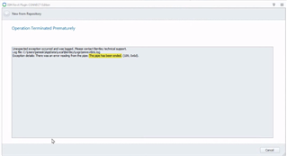

Creation of a repository results in a warning: "Pipe Has Ended"
Steps to Reproduce
When creating a repository from Revit:
Or in RAM Structural System:
Will terminate the export.
This appears to be caused by an antivirus blocking the program (SentinelOne anti-virus).
To remedy the issue, add the following files/folders to the antivirus exclusions list:
C:\Program Files\Bentley\Engineering\iTwin Analytical Synchronizer CONNECT Edition\Synchronizer\iTwinAnalyticalSynchronizer.exe
