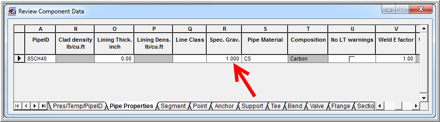

The contents weight is based on the specific gravity of the contents relative to water, where water = 1.0 and gases have very low SG values. and both describe content weight being calculated from the contents' specific gravity relative to water.

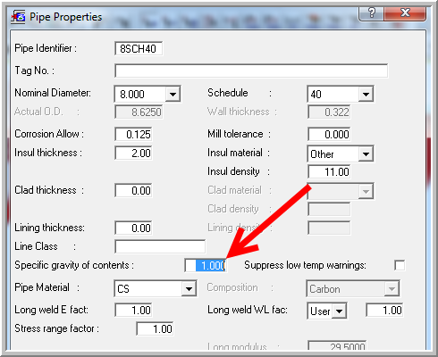

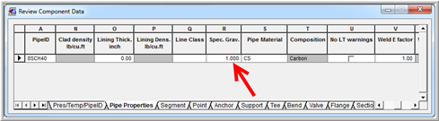

Open the pipe properties dialog and enter the Specific Gravity value related to Water into the field:
Note: As mentioned in AutoPIPE help, Specific gravity is relative to density of Water taken at temperature of 40 deg F and atmospheric pressure (14.7 psi).

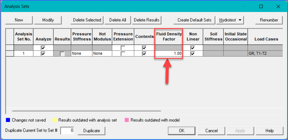

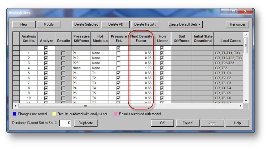

AutoPIPE has a feature on the Load> Static Analysis grid where the user can provide a "Fluid Density Factor" per each analysis set. This factor is multiplied by the "Specific gravity of contents" value for all pipe properties in the model for that analysis set.
Define separate analysis sets for each temperature case and modify the fluid density factor as needed.
Note: Can the fluid density be zero (0.00) or blank? Yes, this is OK. One reason to set the density factor = 0 would be to analyze the piping system in a installed but not operating condition. Another words, this would help users to analyze their model with different states of fluid (no fluid [installed], high temperature, high pressure, etc.) at the analysis level without having to change individual content specific gravity. The 0.0 value of fluid density factor is inclusive of 0.0 value and it does not cause any known problems with any AutoPIPE calculations.

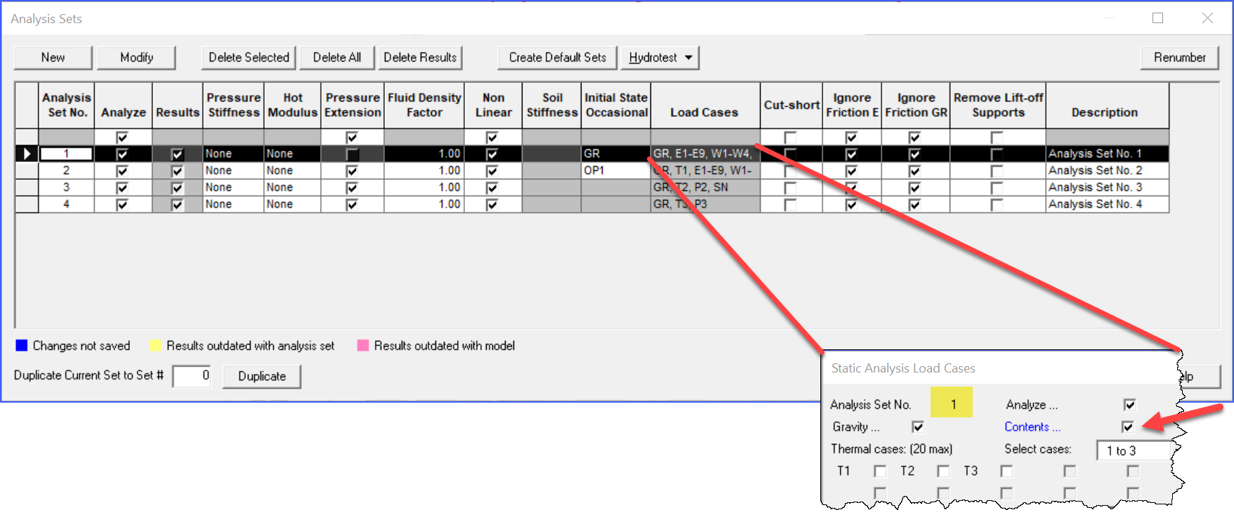

Lastly, be sure to confirm each Static Analysis Set load case dialog for the state of the Contents Checkbox (see help for details on this feature).

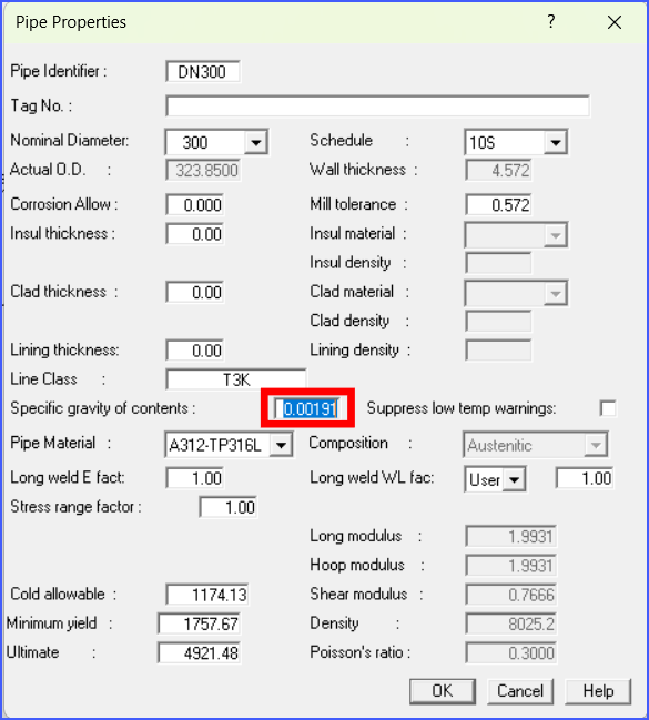

In my pipe system I need to transport air with 15 psig and 100 C, Air density under these conditions is 1.91kg/m3. Is it correct if in the Pipe Properties I write 0.00191 in SG field?
Should I change something in Fluid Density Factor?
Answer:
As mentioned above, the software's Specific Gravity field is defined relative to water density:
Using:
SG = 0.00191
In regards to the fluid density factor, normally leave it at 1.0 unless you intentionally want to scale the fluid mass for a particular load case (refer to AutoPIPE help for details on this setting, then you must determine what the scale factor will be for your project).
