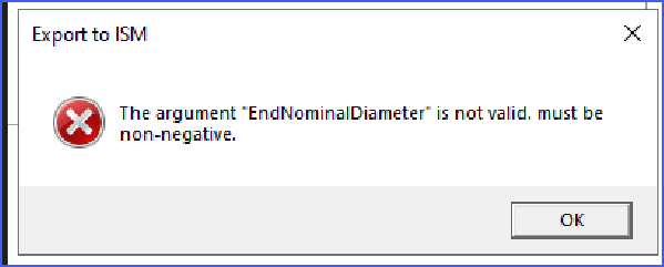

The following message dialog appears when trying to view a Stress iso drawing in OPIM.
Export to ISM
The argument "EndNominalDiameter" is not valid, must be
non-negative
Ok
Why doe this occur and how to avoid it?
 This message was displayed when trying to export a model from AutoPIPE to SACS. There are 2 known issue to cause this to happen:

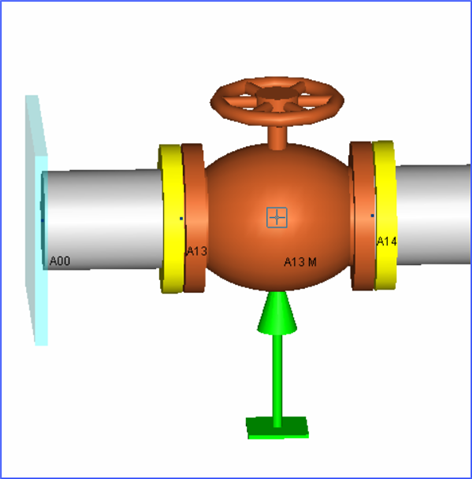

A support located at a valve's center/midpoint node point.
Avoidance:

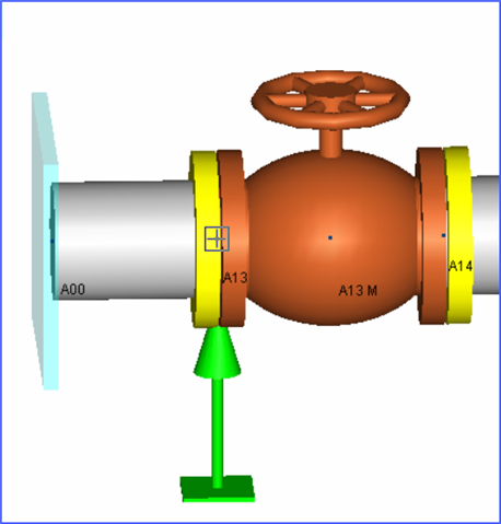

1. Relocate the support to one of the valve's end node point
or
2. Use AutoPIPE 2024 or higher when exporting a model to SACS.
