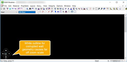

After converting a model from the prior version, or after saving any model with walls in v15.11, the wall geometry can become corrupted. Symptoms include errors in the Data Check, a default zoom factor that is very distant (the plan is tiny), errors running the framing tables, or errors viewing the 3D view.
A corrupt model plan view:

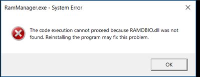

Important Note
If the replacement files are used, then Ram Structural System v15.11 must be uninstalled prior to installing version 16. Otherwise the RamDbio.dll files will not be properly updated and the an error will occur trying to start version 16, "The code execution cannot proceed because RAMDBIO.dll was not found. Reinstalling the program may fix this problem."
