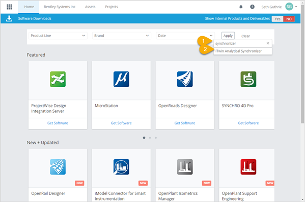

Then click on the Software Downloads tile.

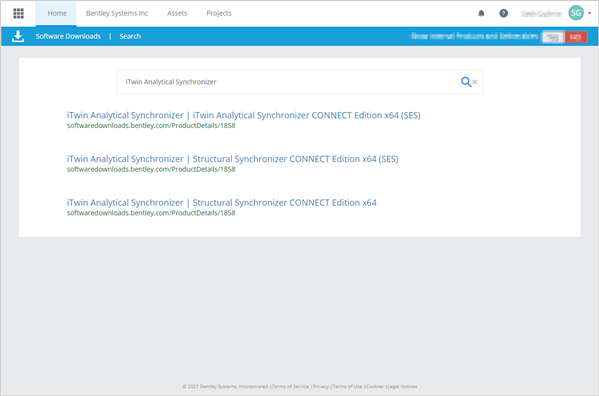

Type part or all of the word "Synchronizer" in the search field and select "iTwin Analytical Synchronizer". Note, use the American English spelling here, "z" rather than "s" in Synchronizer.

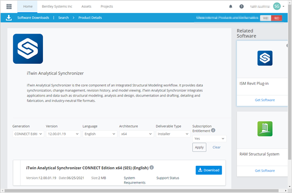

Once found, expand the All Downloads list and select the appropriate version (the top link is fine):
Click the Blue Download arrow button and save a copy of the installation file.
