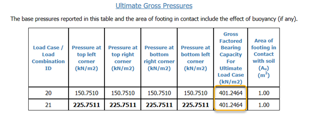

So as per my calculations the factored gross bearing capacity should be = 1.5 [ 200 + 18 x (2+0.5) ] = 367.5 kN/m2. However SFA is reporting the capacity as 401.2464 kN/m2 as seen in the screenshot below

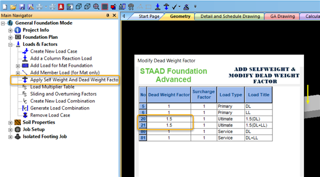

In addition to the factors you have considered above, you also need to check if there are any Dead weight factors specified or not. In your model the ultimate load cases 20 and 21 have Dead Weight Factors specified as 1.5, as shown next
 Thus, the calculation done by SFA for conversion of net bearing capacity to gross bearing capacity is as stated next
a * (200 + 2.5 * 18 * b)
where a = Multiplier on soil bearing capacity for ultimate loads ( 1.5 in your case)
b = deadweight factor specified for the load case under consideration in the "selfweight and deadweight factor table" (again 1.5 in your case)
Thus, the Gross Factored Bearing capacity for ultimate load cases = 1.5 * [200 + 2.5 * 18 * 1.5] = 401.25 kN/m2
