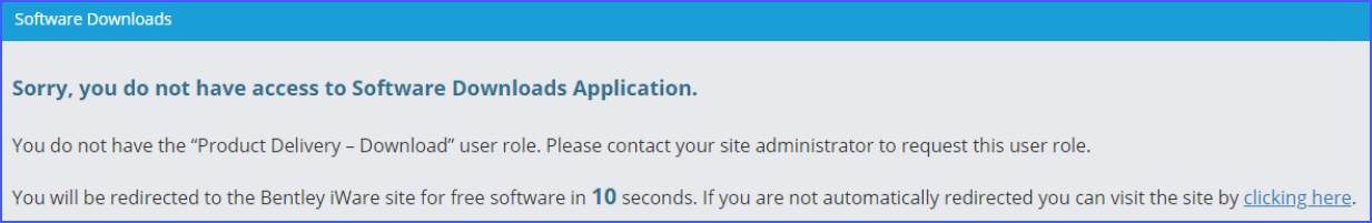

Sorry, you do not have access to Software Downloads Application.

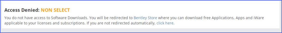

Access Denied: NON SELECT
You do not have access to Software Downloads. You will be redirected to Bentley Store where you can download free Applications, Apps, and iWare applications.

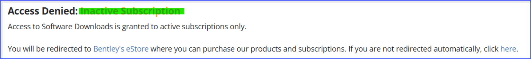

Access Denied: Inactive Subscription
Access to Software downloads is granted to active subscriptions only.
You will be redirected to Bentley's Store where you can purchase our products and subscriptions. If you are not redirected automatically , click here.

1. You do not have "Product Delivery - Download" role assigned to you in User Management.
