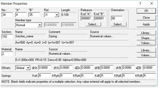

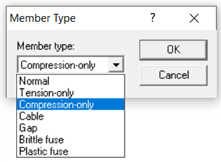

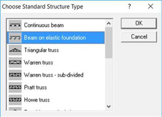

2. Model the Springs as actual members in Microstran, adjust member type as necessary. If you have Microstran, an example of this in action is per below:
Structure à Standard Structures à Beam on Elastic Foundation
Have a look at the resulting structure generated, the springs themselves are actually members in Microstran, with one end connected to the structure and the other as fixed support.
Since the springs themselves are actual members, you can modify the member properties to be “compression only”.
