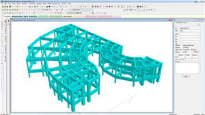

STAAD Advanced Concrete Design (SACD) or RCDC is a Robust Concrete Design Software while is Industry Wide adapted for Designing different elements of a structure.
It helps to reduce the time needed to get concrete designs to site, for engineers who are using STAAD.Pro or ETABS or RAM Structural Systems as the analysis workhorse in their design process.
This new tool will take the model and analysis results to produce full construction production drawings and schedules.

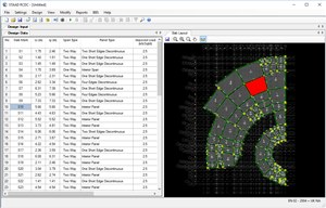

Once the Design is completed in RCDC / SACD, different Design - Reports and Detailed Drawings can be extracted as follows --
Drawing Outputs which are saved in the DXF Formats
  1. Layout Drawings
  2. Detailed drawings in the form of elevations and cross sections / GA drawing
  3. In plan detailing for slabs and footings
  4. Text schedules
  5. Fabrication Detailing - Bar Bending Schedule
Text Reports which are saved in the HTML Formats -
  1. Design summary
  2. Detailed design calculation reports
  3. Bill of Quantities (3 formats)
  4. Other element specific text reports.
