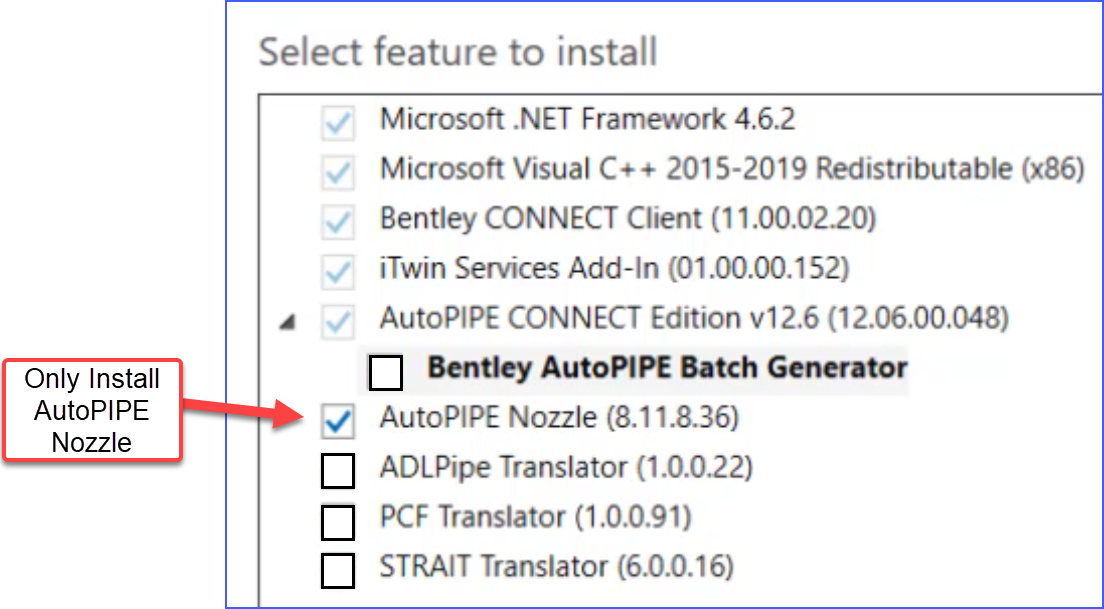

        3. With the installer on the computer, install older version of AutoPIPE, be sure to enable AutoPIPE Nozzle and uncheck all other options (imaged below).
        4.  Once installed, suggest to manually delete any desktop icons, ribbon icons, or start menu icons for older version of AutoPIPE. Recommend not to use window's  uninstall option as this will remove all software installed with the installer.
        5. Prior to starting AutoPIPE Nozzle, log into the Connection Client and verify that either an AutoPIPE Advanced or AutoPIPE Nuclear entitlements are accessible for the individual in their License Management Tool (LMT).
