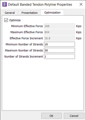

To designate tendon objects as optimizable, view the properties of the banded tendon polyline or distributed tendon quadrilateral, click on the Optimization tab, check the Optimize box, and set the range and increment values (see image below). Non-integer values are permitted for the specified strand number. The minimum value should be calculated based on code required minimum precompression. The maximum value can be based on practical maximum precompression limits.

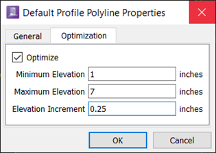

To designate a profile polyline as an optimizable, view the properties of the polyline, click on the Optimization tab, check the Optimize box, and enter values for the elevation range and elevation increment (see image below). Typically, support profile polylines (high points) will be set to the highest possible elevation respecting cover requirements and defined with the Optimize box unchecked. An exception is the high point at a cantilever, which may need to be reduced from the maximum value so the cantilever is not overbalanced. The span profile polylines (low points) will typically be defined as optimizable.
Note that the elevation values set in the optimization tab refer to the “Elevation Reference” set in the general tab. For example, if “Elevation Reference” is set to “Above Soffit” for a support polyline, then the values will be measured from the bottom of the slab. We recommend using a wide range for the profile elevations, as counterintuitive values may be associated with the optimal design.

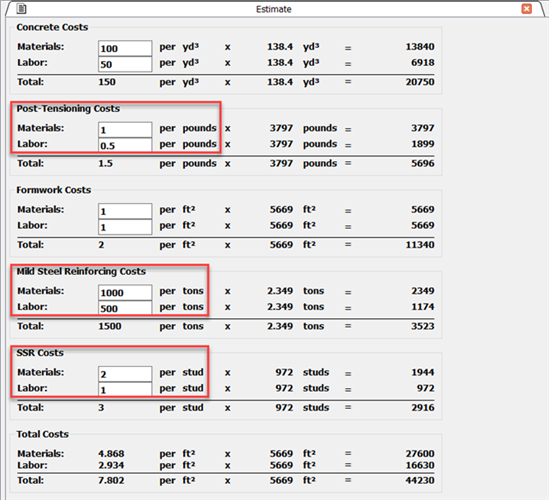

The optimal design is the design that minimizes the total material and labor cost of PT, rebar, and stud rails and has no design code failures. To calculate the material and labor costs, the program multiplies the PT, rebar, and SSR quantities by the cost factors that are defined in the Estimate window accessed from Reports > Estimate (see image below).
In general, the default cost factors will work well for most optimizations. However, the material and/or labor costs of any one of the reinforcement components can be changed for a given project to account for regional cost differences or favor certain design alternatives (for example, those not requiring SSR). When modifying the default cost factors, the relative cost among the PT, rebar, and SSR is more important than entering the actual material or labor cost for the job and location being designed.

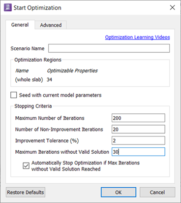

After the preprocess, the Start Optimization dialog appears (see image below). To start the optimization, enter a Scenario name, review the Stopping Criteria settings, and then click OK. In general, the default settings in the Start Optimization dialog produces good results in nearly all models.

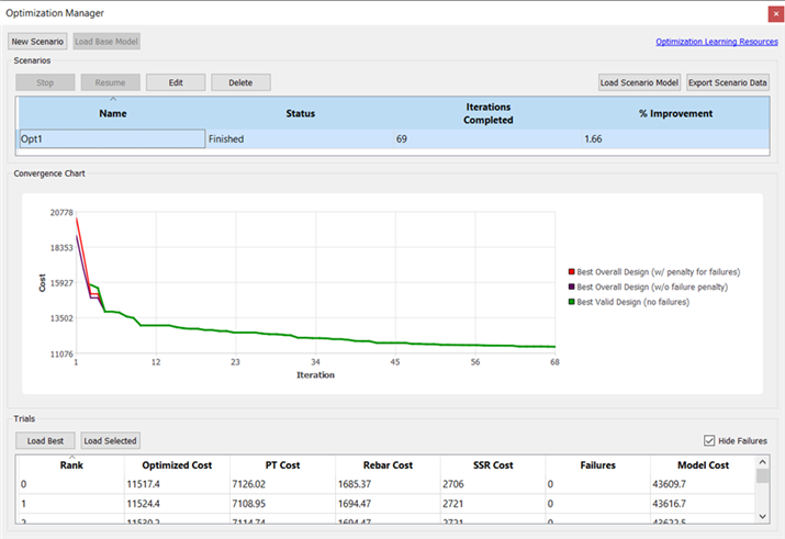

During the optimization process, the Optimization Manager window (see image below) may be used to periodically monitor convergence or verify that valid solutions have been found. The Optimization Manager is launched by selecting by selecting the Optimization Manager tool ( ) or clicking Optimization > Optimization Manager.
The Optimization Manager window shows the status of the optimization (running, stopped, run failure), the number of iterations completed, % improvement, and details of the total cost of each trial completed during the process.
The Stop button can be used to stop the optimization process at any time. You may want to stop an optimization if you see most of the trials have failures or if the optimization process seems too slow to converge to a solution. The Resume button can be used to continue trials that were stopped.
The Convergence Chart tabulates the Total Cost (y-axis) versus completed Iterations (x-axis) for the selected scenario. Three lines are plotted: Best Overall Design (with failure penalty), Best Overall Design (without failure penalty), and Best Valid Design (no failures).
The Trials Table at the bottom of the Optimization Manager displays the cost information and failures for each trial analyzed during the optimization. The values in the tables can be sorted by clicking on the column headers. For example, click once on one of the Cost column headers to sort the trials from ascending or descending values. If you click on the Failures column first and then Total Cost, the trials will be sorted by number of failures from least to greatest and also sorted cost by total cost. So, all trials with 0 Failures will be listed at the top of the dialog and all trials with 0 failures will also be sorted from least to greatest cost.
