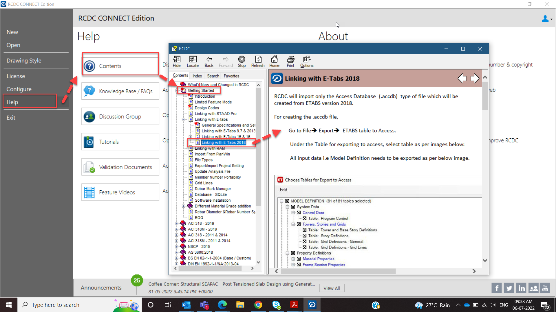

ETABS file of version 20, can be imported in RCDC without ETABS database tables to Access??
Yes  RCDC can import only the database *.accdb created from any version of ETABS.
You can find the full procedure on how to export and generate .ACCDB file in RCDC help content .Please find the screenshot for your reference.
