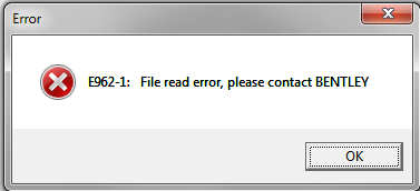

E962-1: File read error, please contact BENTLEY... message appears when using AutoPIPE, why?
Product(s): AutoPIPE,
Version(s): ALL
Environment: N/A
Area: Error
When trying to open a AutoPIPE model the following occurs?
Error
OK
Recover File

Fix File
Consideration #1:
If message above was displayed while trying to conduct a dynamic analysis, check the user specified dynamic files (ex. TIH, THL, HMF, SPC)  to be sure that they are properly formatted.
Example.
If trying to perform a Time history analysis, message was displayed, upon inspecting the TIH and THL files it was discovered that the 1st line was blank. According to the AutoPIPE help the first line always contains information. Simply removing the blank line, saving the file, and now the Time History analysis is completed without displaying the message above.
Consideration #2:
If your model has a custom material or unit library, remove the library and then try and open the model. If the model opens, then it was directly related to the customized file.
Consideration #3:
Address as many warnings and errors to be as few as possible. Yes, warning should not be an issue, however best to get rid of as many as possible to rule them out.
Consideration #4:
Save the model back to a previous version in a different folder than the original model. Then, go ahead and open that newly saved file from its new folder location and run the model to get your results.
Consideration #5 (Last resort):
As a last resort round trip the model as mentioned here. Warning, be sure to follow these instructions carefully.
