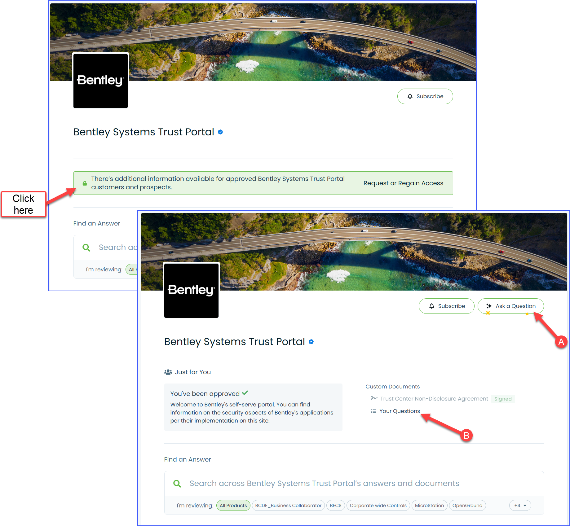

Note: After opening the Trust Portal for the first time, please select the banner as indicated below to see additional features (ex. submit question, etc..)
a. Select button "Ask a Question" to submit your personal question.
b. Select hyperlink "Your Question" to see previously asked questions.
