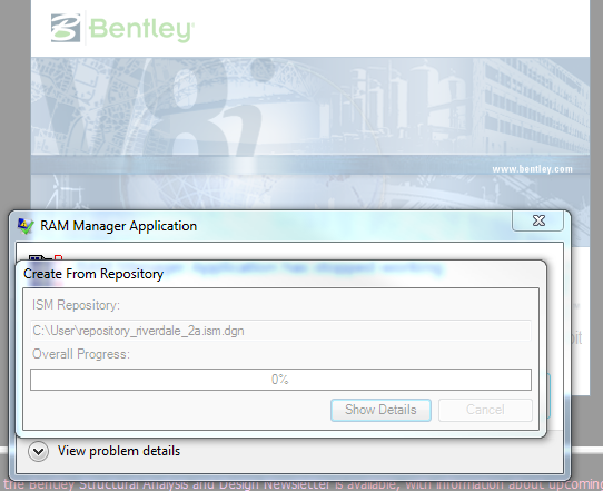

Problem Description
When using the RAM Manager - ISM - New from repository, RAM Manager may crash and no model is generated.

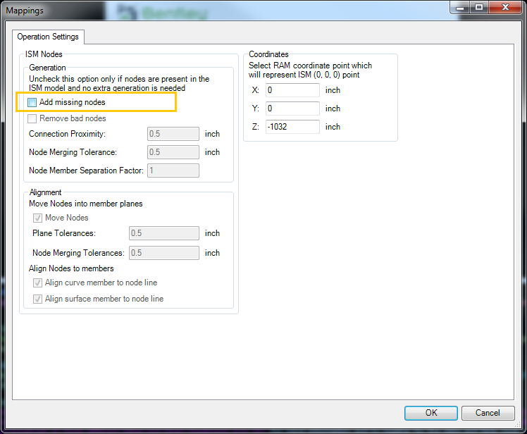

In some cases the problem is limited to complex structures where the generation of additional nodes causes an exception. To rule this out, step through the import process again, and on the second screen of options called "operation Settings" uncheck the first option on the left to "Add missing nodes"
If the process still crashes, send the repository to the technical support group through a forum post or Service Request and reference this article.
