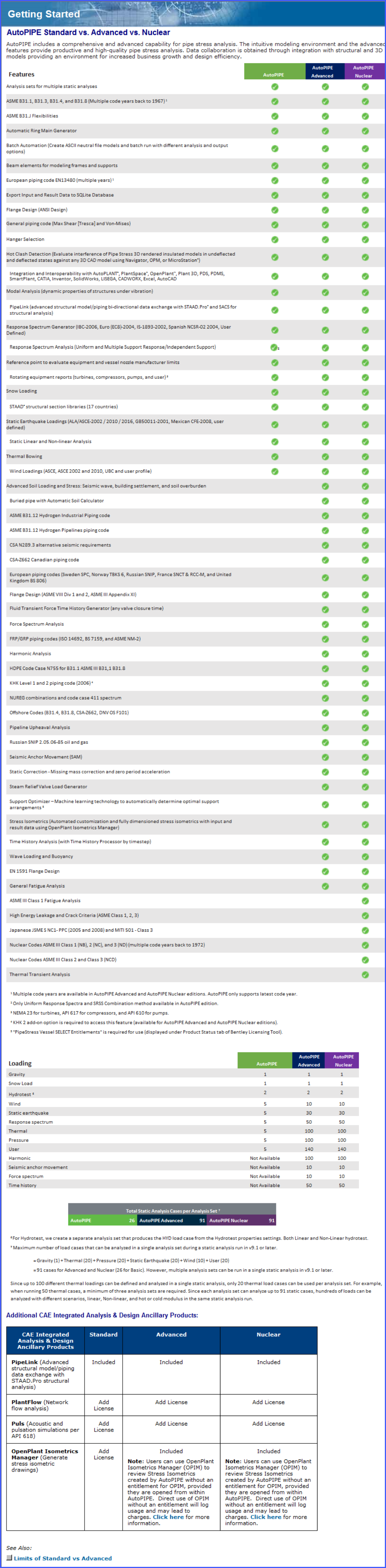

-Q. What Features and Piping codes are available in AutoPIPE Standard, Advanced, or Nuclear?
What Features and Piping codes are available in AutoPIPE Standard, Plus, or Nuclear?

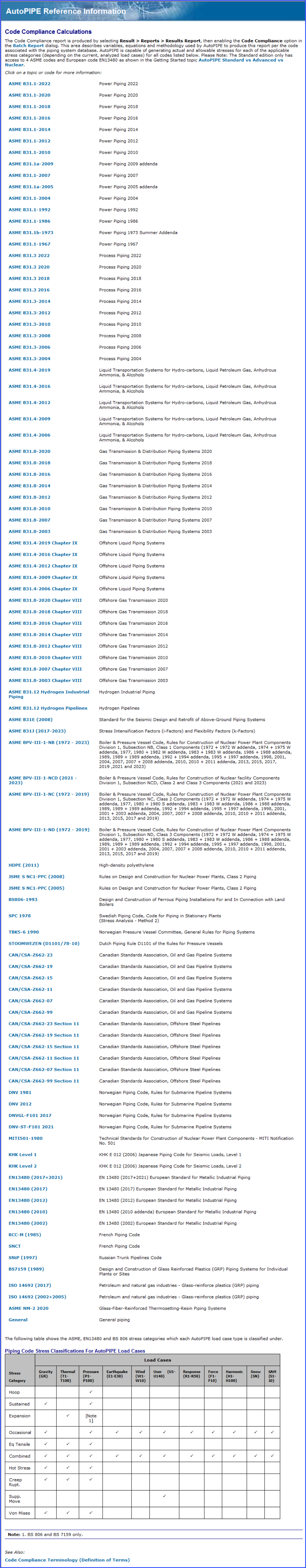

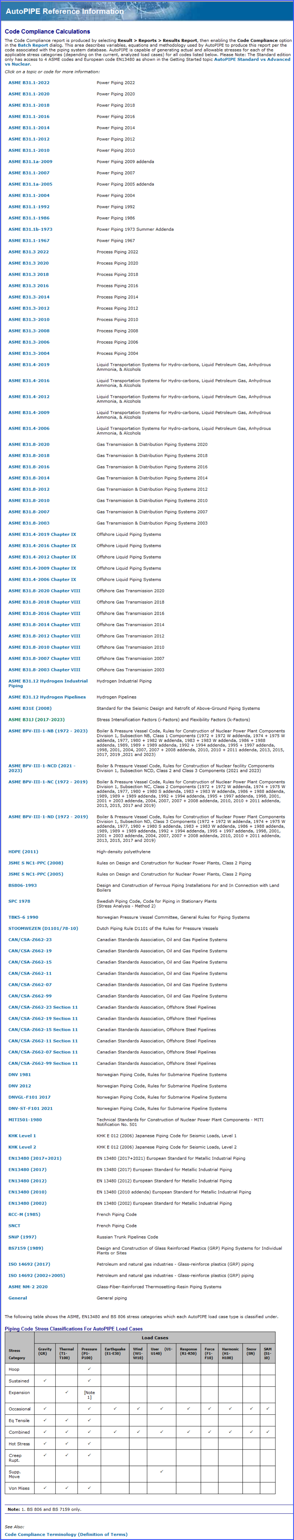

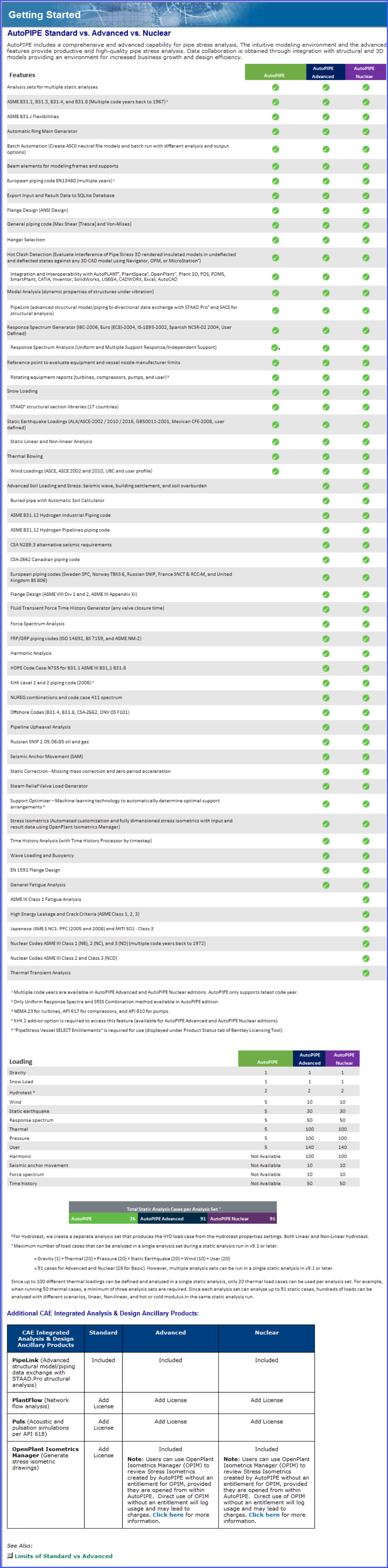

See the comparison chart between AutoPIPE Standard, Advanced, and Nuclear below. In addition see list of piping codes currently in the program:
The same information is available in AutoPIPE help:
Help > Contents> Contents Tab> Bentley AutoPIPE>  Getting Started> AutoPIPE Standard vs Advanced vs Nuclear
and
Help> Contents> Contents Tab> Reference Information> Code Compliance Calculations> Code Compliance Calculations
