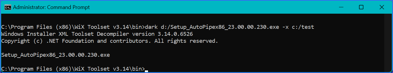

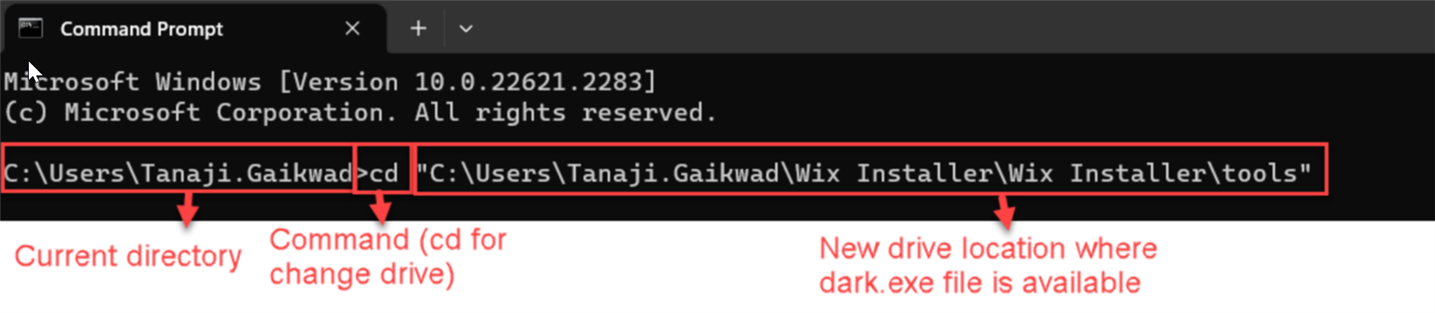

a. After installing Wix Tool Set, locate the Dark.exe program. (default location: C:\Program Files (x86)\WiX Toolset 3.xx\bin
b. Open a CMD prompt.
c. Change directory to the folder containing the Dark.exe application.

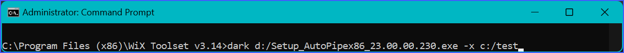

d. Using the following syntax extract the files to a folder location:
dark.exe {Path_to_setup.exe} -x {Directory_Path}
Example:
Extracting files from AutoPIPE 23.00.00.230 EXE file to a folder called Test
dark d:/Setup_AutoPIPEx86_23.00.00.230.exe -x c:/test
e. Press Enter (return key ) to run the command.
f. The command has completed once the command prompt reappears

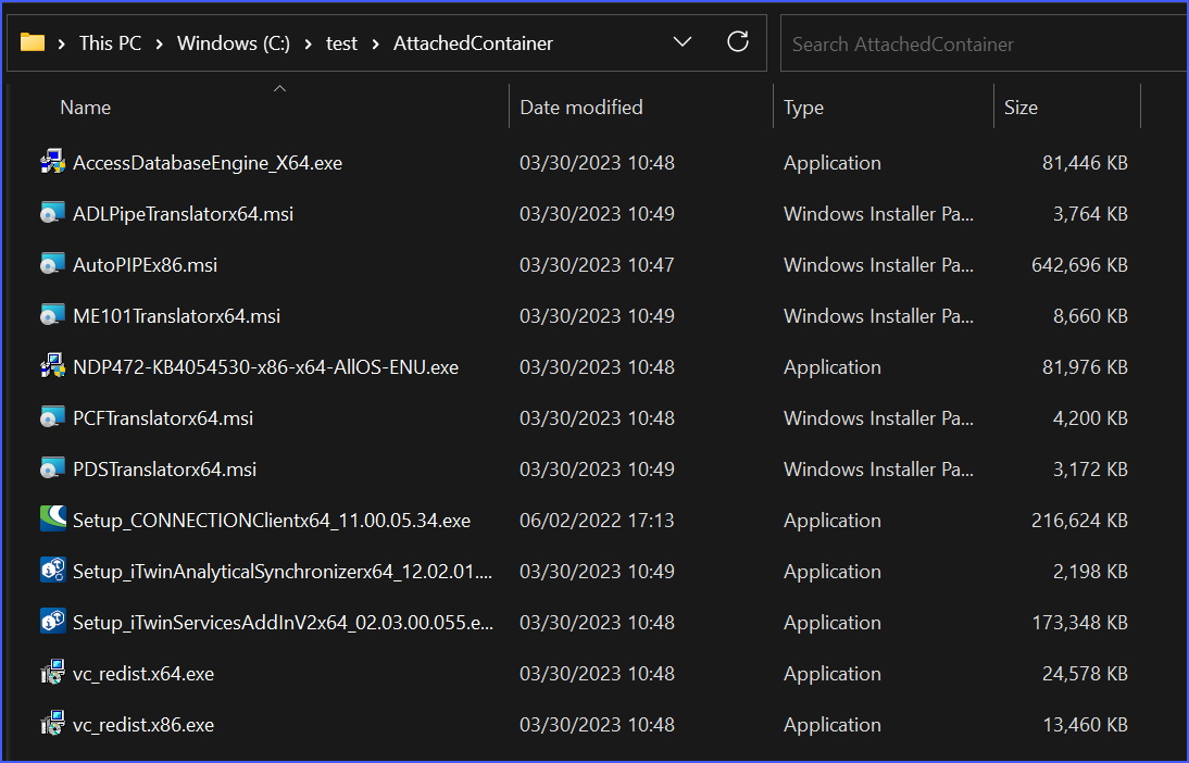

g. Go to the "Directory path" specified to see the files extracted
Note: open the AttachedContainer subfolder (example shown below)

Next install AutoPIPE's MSI file extracted from the EXE file installers
In addition, install only those Optional Applications planning to use:
