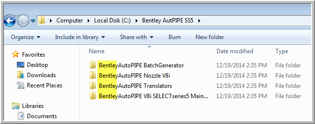

Work Around
Add a word at the end of the path. This word will be added to start of each installation folder.
Example:
Setup.exe -s InstallFolder=”C:\Bentley AutoPIPE SS5\Bentley”
This will install AutoPIPE and other tools to folder “C:\Bentley AutoPIPE SS5\” and all folder name will be preceded by “Bentley” as shown in image below
