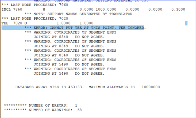

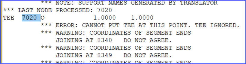

The following appears in the *.MSG file when importing a caesar file, why?
*** ERROR: CANNOT PUT TEE AT THIS POINT. TEE IGNORED.
This is caused when a tee is configured for a location that AutoPIPE cannot physically place a TEE because of an internal component connection based on the CII configuration. Essentially a Tee or branch connection cannot be inserted on any AutoPIPE component other than pipe run. Exampled of AutoPIPE components that DO NOT support Tee / Branch fittings: Bend, Valve, Reducer, Flange, Nozzle. Placing a Tee / branch component will cause the file not to open in AutoPIPE.
There are 2 different solution to this problem:1. Fix the CII file or 2. Fix the AutoPIPE converted NTL file
Note: see bottom of article for solutions to various scenarios encountered while importing a CII fil.

Option #2:
a. In the same folder as the CII file, during the import process AutoPIPE created a NTL file. Open NTL file in Word Editor (ex. Notepadd ++, Ultraedit, etc. )
b. From abort MSG text file see the error message, the line above starts with Tee, note the number just after Tee, ex. 7020
c. Search the file for all occurrences of this this value,

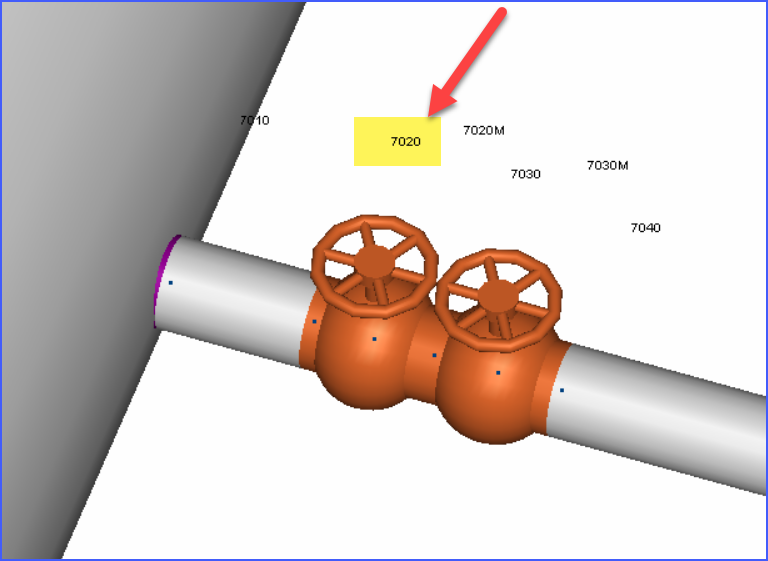

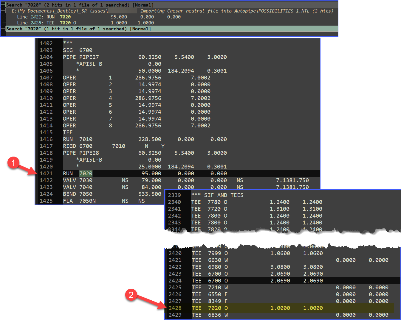

Scenario #1: Valve Sensing line
Following error shown when importing a model.
Text found in converted NTL file:
Starting on line 1402 of the NTL text file:
With the Batch card help information one can read that a new segment starts at node point 6700, run component from 6700 - 7010 with rigid properties, followed by another run component to node point 7020, valve from 7020 - 7030, valve from 7030 - 7040.
Question: Why can a Tee not be placed at node point 7020?
Answer: As mentioned above, AutoPIPE components cannot have a tee / branch connection.

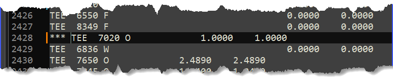

This may have been a pressure sensing line attached to the valve's flange. After the model has been opened in AutoPIPE, select the valve's node point, insert a new segment a short distance away  continue modeling the pipe/tubing. Go back to the vale's node point insert a connected anchor to the new segment created.
Resolution, Delete the corresponding Tee SIF card (del or REM line 2428 of this file),
save the file, and open NTL file in AutoPIPE.

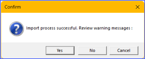

Zoom to node 7020:
Done!!!

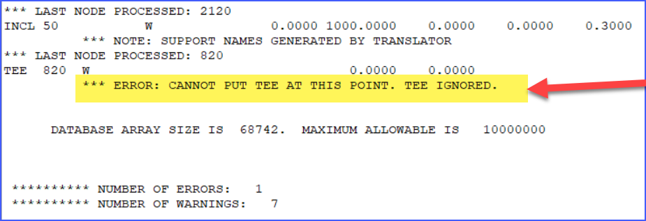

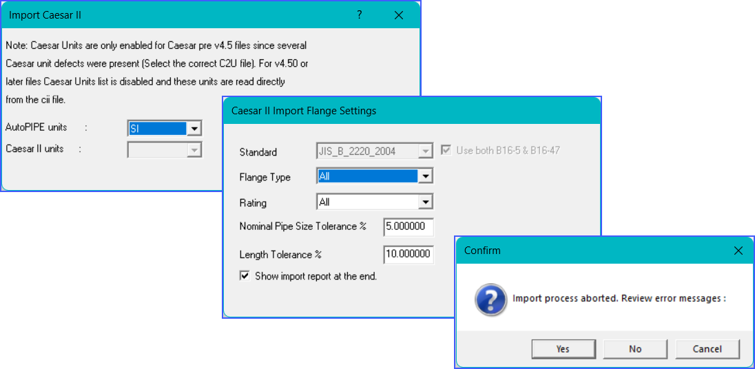

The following appears when importing a CII model into AutoPIPE:
Confirm
 Import process aborted. Review error messages :
Yes   No   Cancel
Question:
Where is the problem and how to fix it.

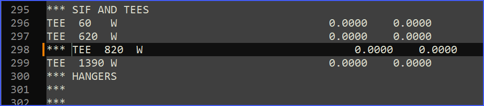

Suggest the following steps to resolve this issue

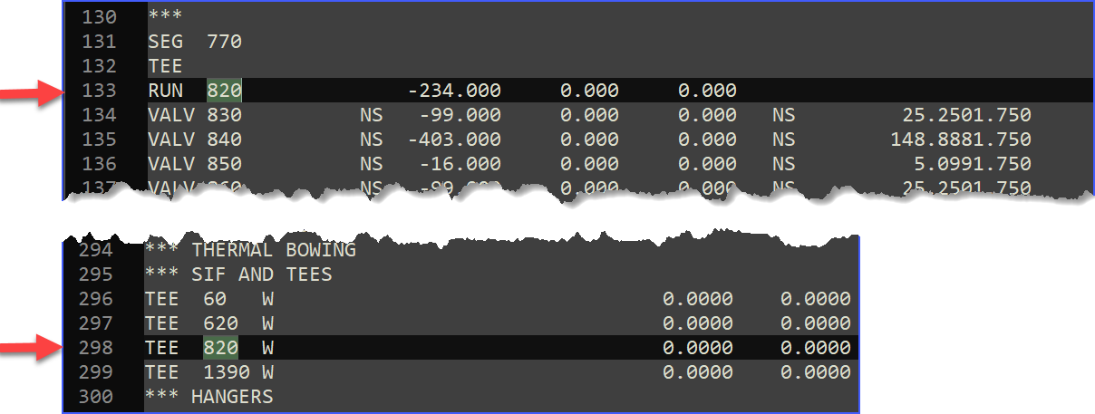

    1. First open the AutoPIPE converted NTL file in a word editing application (NotePad++, Ultra Edit, etc..)
    2. Search for all occurrences of "820" in the NTL file.
    3. The following was found

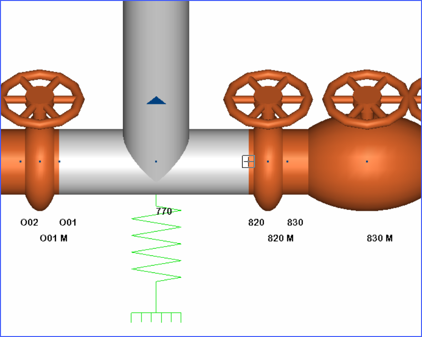

    4. Again what is the problem, hint same as scenario #1 above,
    5. Correct Remove or comment out line 298, line was commented out of the file by insert "***" at the start of the line
    6. Save the NTL file and try to Open the NTL file in AutoPIPE.
    7.

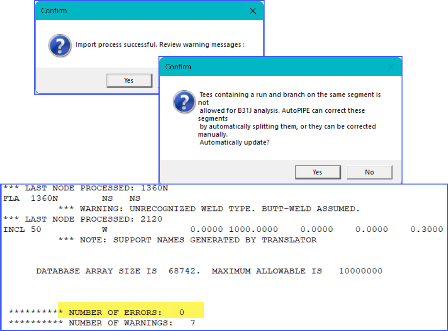

Conclusion
The imported CAESAR II (CII) file contained a tee SIF located at the face of a flange. This configuration is equivalent to a flange sensing-line connection, which is not supported by AutoPIPE. As a result, the model could not be imported successfully. The issue was resolved by simply commenting out the sensing-line SIF entry in the CII file before import.
Recommendation
Before exporting a CII file for use in AutoPIPE, verify that the model does not contain:
Removing or modifying these unsupported configurations prior to export will help ensure a successful import into AutoPIPE.
