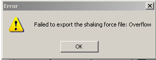

Item #3:
The following is displayed when exporting shaking forces:
Error
Failed to export the shaking force file: Overflow
OK
Answer:
During the creation of the HMF file using File> Export> Shaking Forces, for some models the program may crash if the Analyze> Force direction command shows the AutoPIPE axes to be zero vectors.
A new enhancement (CAE-CR-7856) has been added to a check for zero cosines when using File> Export forces.
It is unknown what causes 0 direction cosines in some models.
Workaround,  if direction cosines are zeroes, set them to unit vectors by using "Edit> Shaking Forces".

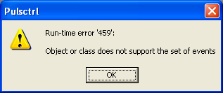

Item #4:
When I run puls and try to open a model I see the following
Pulsctrl
Run-time error '459':
Object or class does not support the set of events
OK
 And then the following appears:
Bentley PULS
Run-time error '440':
Automation error
OK
Have you seen these before, and if so any suggestion to fix?
Answer:
You probably have wrong pulsctrl.ocx. This is the correct one. May need to un-install and re-install. Make sure PULS is 8.9.0.28 or 29.
Directory of C:\WINDOWS\system32
09/18/2007 04:54 PM 151,552 Pulsctrl.ocx
Please follow this procedure
1. Uninstall PULS
2. Unregister OCX
          Then change directory to Windows\system32 and type "regsvr32 /u pulsctrl.ocx"
3. Delete pulsctrl.ocx
4. Remove C:\Bentley\PULS folder
5. Install again

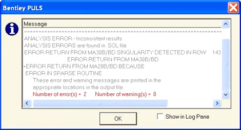

Item #7:
I am receiving the following error when trying to run a number of models in PULS XM.
Analysis Error - Inconsistent results
Analysis Errors are found in SOL file
ERROR RETURN FROM MA30B/BD SINGULARITY DETECTED IN ROW  143
                            ERROR RETURNED FROM MA30B/BD
ERROR RETURNED FROM MA28B/BD BECAUSE
ERROR IN SPARSE ROUTINE
     These error and warning messages are printed in the
     appropriate locations in the output file
Answer:
Issue was fixed on this particular model by modifying the speed range.

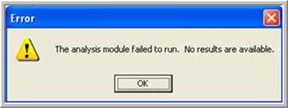

Item #11:
When I run PULS analysis, the following is displayed:
Error
The analysis module failed to run. No results are available
OK
How to fix this?
Answer:
There are 2 known reasons why this message would be displayed:
a. The file saved as a text file. It needs to be saved as (*.* All files) type of file. Workaround, copy the contents of the file into a new file called puls_in1.txt and it worked.
b. Computer maybe out of memory, Workaround, Ask IT to review system resources and update computer as needed. Or save to more suitable folder location.

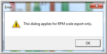

Item #13:
Logged : November 2014
The following Appears when trying to use File> Export Forces.. command in PULS:
Error
This dialog applies for RPM scale export only.
OK
What does this mean, and how to export my loads to AutoPIPE?
Answer:
In order to export forces to AutoPIPE, model  component in your model that required an RPM setting, (i.e. Pump, Compressor, etc..). A model with only a pressure sources will not have a setting to change the RPM scale and therefore cannot export any loads to AutoPIPE.
Example:
Open up PULS example model, C:\Bentley\PULS XM\Project\RECIPP.LP1, Analyze the model, and try to use the File> Export Forces command. In a moment, a dialog appears that allow the user to enter in Export Speed, Damping Ratio, and file name for the program to create a  *.HMF file for import into AutoPIPE.
Now, open up PULS example model, C:\Bentley\PULS XM\Project\PRESSURE.LP1, Analyze the model, and try to use the File> Export Forces command. Notice that the Error above appears. Again, model a component that requires entry of an SPEED value.

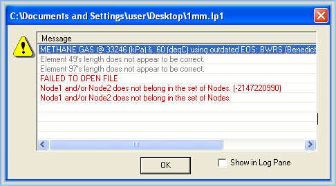

Item #14:
The following Appears when trying to import a model from AutoPIPE:
Element length does not appear to be correct
Failed to Open
Node1 and/or Node2 does not belong in the set of Nodes. (-2147220990)
Why and how to avoid?
Answer:
In one case the imported model contained reducer that were only 1.00 mm long. Puls cannot import a reducer of this length. Go back into AutoPIPE and change redcuer length from 1.00mm to 2.00mm or longer.

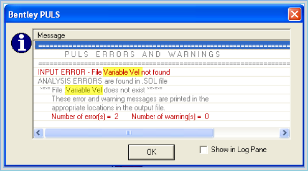

Item #15:
Logged : Oct 2018
P U L S E R R O R S A N D W A R N I N G S
INPUT ERROR - File Variable Vel not found
ANALYSIS ERRORS are found in .SOL file
**** File :Variable Vel does not exist ******
Note: Highlighted text is the name of the file that cannot be found, this name may be different in your error message.
Answer:
There are two important things to remember about PULS:
a. File names need to adhere to DOS 8.3 filename convention (see website here) .
b. Place file inside the model folder
Following these 2 requirements fixes the above input error of not finding the file.

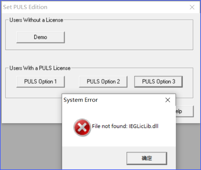

Item #15:
Logged : Jan 2024
The following is displayed when starting / licensing PULS:
File not found: IEGLicLib.dll
User must Download and install Bentley IEG Services. This is a separate program running in the background to license the application. See WIKI here to download application MSI file.
Installation instructions:
IEG must be installed by user with Admin privileges and cannot be pushed over a network connection. Please confirm you are logged on as an admin user, do not assume.
1. Un-install any previously installed version of Bentley IEG License Service from Control Panels 'Add or Remove Programs' or "Program and Features"
2. Locate the IEG file downloaded
3. Select “Start” , “Run”, or “Browse”
4. Open the folder and run “iegls02002001en.msi”
5. Accept all the Default settings.
6. *** important*** reboot your computer.
7. Confirm IEG has been installed, using Add and Remove programs,.
Note:
1. On Win 10: IEGLicLIb.dll file should be located under C:\Windows\SysWow64
2. Install 32 bit version of Bentley IEG, The 64 bit version will not authorize the application as the program is a 32 bit application.
Assuming that the rest of licensing is working / configured correctly, PULS should now open and license without showing the aforementioned system error.
