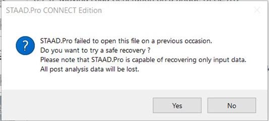

We have had reports of software crashes in the STAAD.Pro CONNECT Edition version 22.02.00.26. The crashes are mostly random in nature and the STAAD.Pro development team is going through all the crash reports and trying to address these on a top priority basis. Although these crashes are not reproducible in most cases, we have observed that certain actions like closing out of the editor, resizing a view, dragging a view window, carryout out a steel design as per AISC 360-16 etc. have caused comparatively more crashes than others. In most cases (if not all) that we have observed so far, there is no data loss associated with these crashes. Also if there is a crash or an abnormal shutdown of the software, there would now be a file named “Modelname_AutoRecovery.zip” within the same folder where your STAAD.Pro model is, that would have all the updates made to the model up to the crash. You may use this zip file to retrieve any data. When you open the model after the crash, you will get the following message box.
Choosing Yes will recover any data and prevent any data loss.
