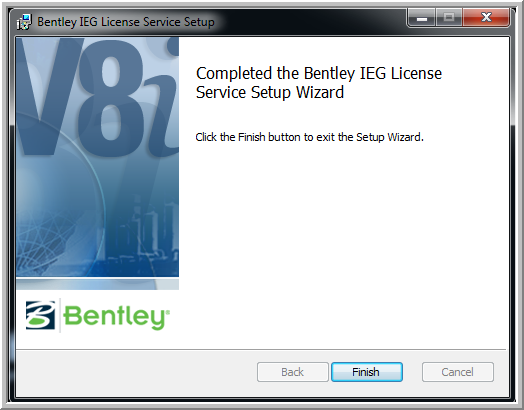

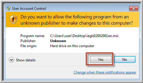

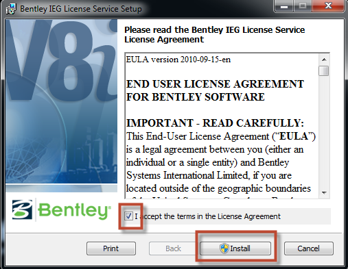

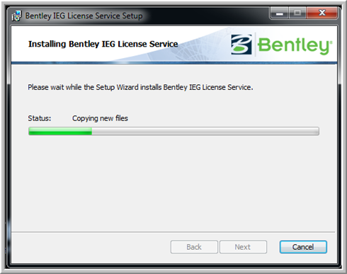

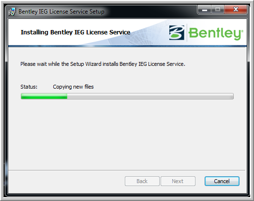

Step #3: Install Bentley IEG License Services:
Bentley IEG Select Service is required to license the PULS application.
Notes:
a. Application information - click here (contact Bentley Licensing Team for download)
Please perform the following steps:
1. User must log onto user's computer with full Administration rights.
2. Suggest that Bentley IEG License Services is installed while accepting all the default settings.
a. Prefer that the application is not installed over a network connection; suggest that the EXE file is on the users' system before starting the installation.
b. If Bentley IEG Service has already been installed, confirm version is the most latest. If not, uninstall all previous versions of program.
c. Navigate to the EXE file download using the procedure above.
Default:  C:\Downloads \Bentley \
d. Double click on the "iegls02002001en.msi" to start the installation process.
Attention: Do NOT start the program at this time. Continue to the next section.

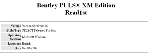

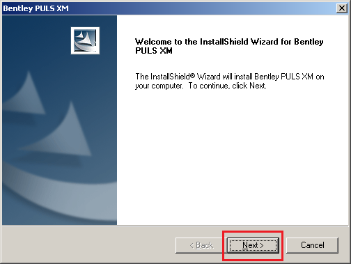

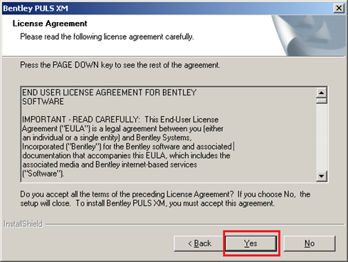

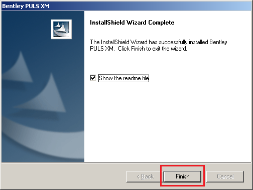

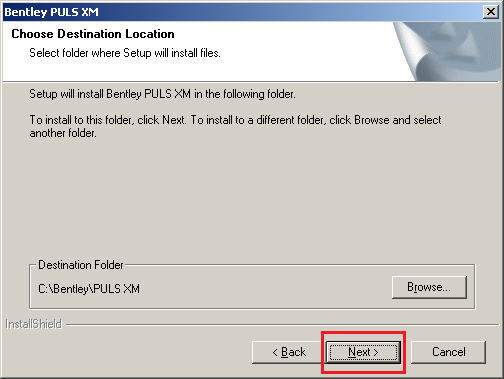

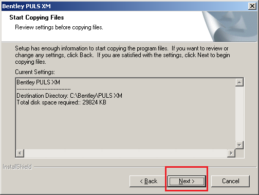

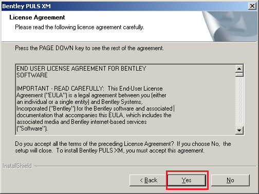

Step #4: Install PULS XM 08.09.xx.xx
2. Suggest that PULS XM is installed while accepting all the default settings.
a. Prefer that the application is not installed over a network connection; suggest that the EXE file is on the users system before starting the installation.
b. If you have already installed PULS XM, uninstall all previous versions of PULS
d. Double click on the "pls08090028en.exe" to start the installation process.
Note: Be patient while the application is installing as it is checking to verify programs already installed, verifying drive space, etc.. there may be periods when it appears nothing is happening. Give the system time. In the event the installation stops a warning / error will be presented. Just follow the prompts and be patient. Highly recommended that all applications are closed during the installation process. On average it will take 6-8 min to install everything.

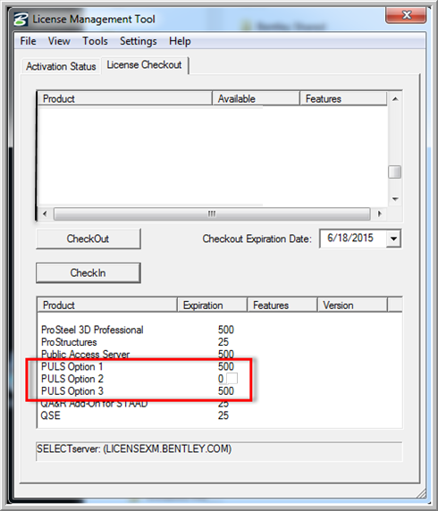

Step #6: Set-up Licensing
Updated Jan 2024:
With SES licensing accounts, company appointed Bentley On Site Admins, must check out a license from SES, send the file to the user, and import into the users' LMT applications.
1. Press START> All Programs>  Bentley> PULS XM> "License Management Tool".
2. Select the License Checkout Tab, scroll down the listing looking for PULS Option 1, 2, and/or 3 as shown below.
Application Name is missing from the Product Listing:
Reasons Why the application name may be missing from the Product Listing:
A. The application is not on your SELECTserver. Contact Bentley Licensing to confirm applications on your contract and when your contract will expire.
B. The SELECTserver has not been updated. Press F9 keyboard key (generally located on the top row of a keyboard), the application is sending log information back to the Bentley hosted server, wait just a moment for the light show to stop. At this point the product listing will be refreshed with the latest SELECTserver information. Search the product listing again for PULS Option 1,2, and/or 3.
C. There are check out restrictions on the SELECTserver for the user and or the application. Please contact your Bentley On-site admin or Bentley Licensing Department. Only these people have access to the SELECTserver and will be able to look up and see where the licenses are located and what checkout restriction may be in place.
If you are a Bentley On-Site admin see more information about "Client Access Restrictions" and  Custom Activation Groups.
If the License is in use by another, consider increasing your pooled license, contact your Bentley Account Manager for options and pricing.
3. Check the "Available" column to the right of the application
Is the value >0 ?
If the Value is greater than 0, therefore a license is available for the application, start PULS.
Is the value = 0 ?
If the value is = 0, this means that there is no license available for this application in your current checked out license. Therefor the program will revert to DEMO model if you try to start it until such time that this value is > 0. go back and get a different checked out file from SES

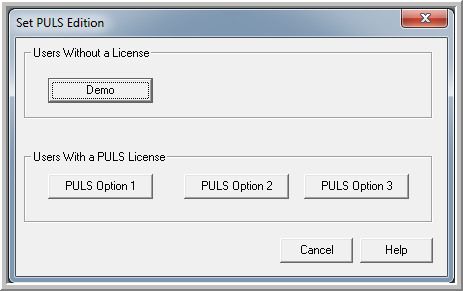

Step #7: Start Bentley PULS
***important***  Before continuing, reboot the computer.
1. Start PULS by double clicking on the desktop icon or from the Start Menu> Bentley>  PULS XM
2. When you first start the Bentley PULS, a License screen will appear (or with PULS started, select Tools> Set Editions):
3. Based on the Product(s) that were available in the License Management Screen above, select a PULS license that had more that 1 available license (Example, based on image above, PULS Option 1 or 3 are valid selections). If PULS Option 2 was selected the application would have reverted to DEMO model because as shown above in the LMT screen, PULS Option 2 has 0 license available.
4. If the program reverts to DEMO mode see steps above on Things To Try:
