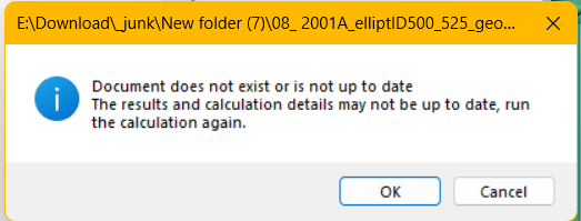

The error "output result required" means that the UI tried to read results data in the EMVD file. However, if the calculation has crashed, then there is no results to read when this message box is displayed, there should have warning/error message in the Report, to explain why there is no output.
If there is no report,
that means the calculation has stopped before retrieving the error (i.e. crash). Complete review of the model must be completed by hand in the software.

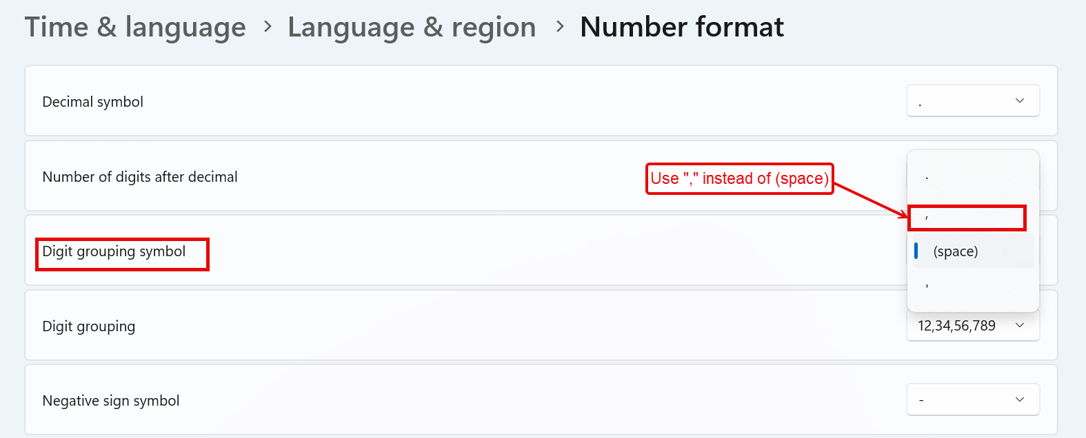

If yes, then reason could be in Regional setting as follows:
This issue is encountered by French users because the thousands separator (Digit grouping symbol) may change for France in the regional settings between different versions of Windows.
The problem is due to the selection of the “Digit grouping symbol” in Regional Settings (Time & Language > Language & region > Number). For some unknown reason, selecting “(Space)” generates a narrow non-breaking space character that AutoPIPE Vessel cannot handle, causing the program to show the error message. This issue may not affect every computer.
The workaround, select " , " from the list, do not set to "(Space)" as imaged below:
For more details: Fix the thousands separator difference between Windows 10 and Windows 11

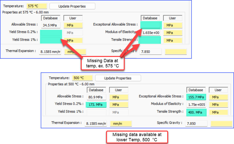

    1. Example:
    2. Review Temperature related properties on Component's Material tab.
    3. If material information is missing, ex Yield Stress imaged above.

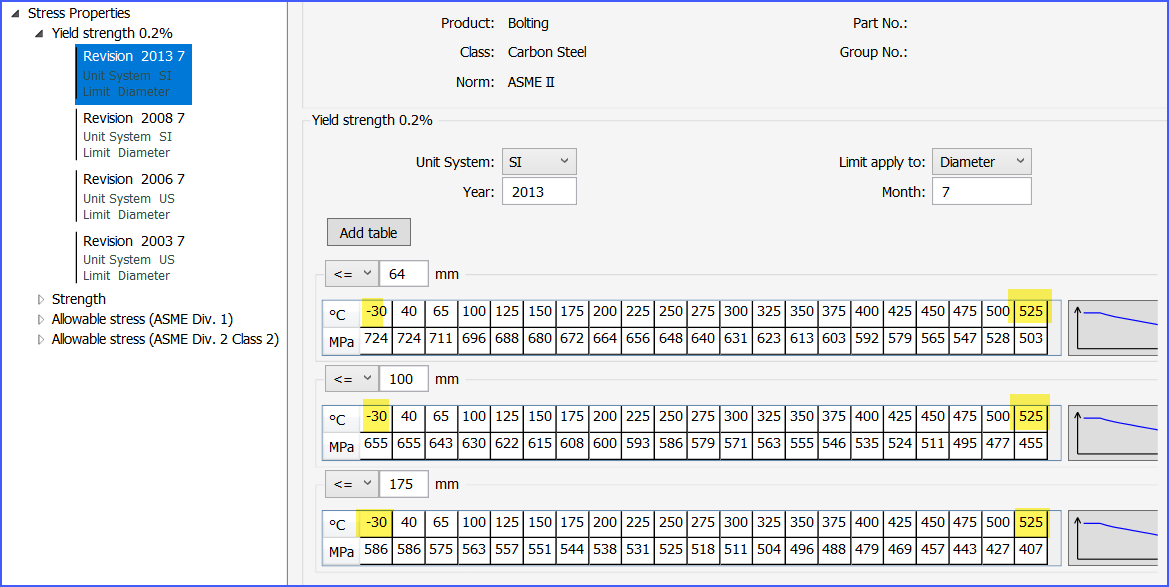

    4. Examine the material library to be sure the designated temperature is within the range of the material.
    5. Temp = 575 °C., for this example material Yield Stress ranges from -30 °C to 525 °C. The Output Error appears because the material does not have data to 575 °C.
    6. Workaround:
      1. Choose a different material that has a higher range: 575 °C or higher
      2. OR
      3. Extend the range of the current material table with qualified data source beyond 575 °C

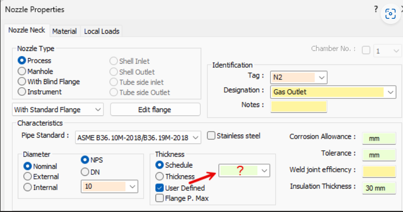

In cases where Nozzles are defined as Self reinforce and no thickness is provided:
Suggest to set all nozzles to With Or Without Pad.
Otherwise, IF a self-reinforce type is needed, then you could input the thickness of the self instead of leaving them blank.
Suggestion #5:
In addition, check the following missing thickness information on the Nozzle Properties dialog contains a value when set to User Defined:

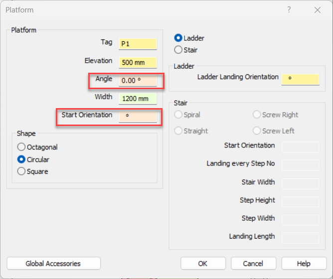

In addition, check the following missing data in Platform. Fill the appropriate data to avoid the error.
Incase you choose the Octagonal shape, platform must have an angle >= 45 ° (8*45=360)

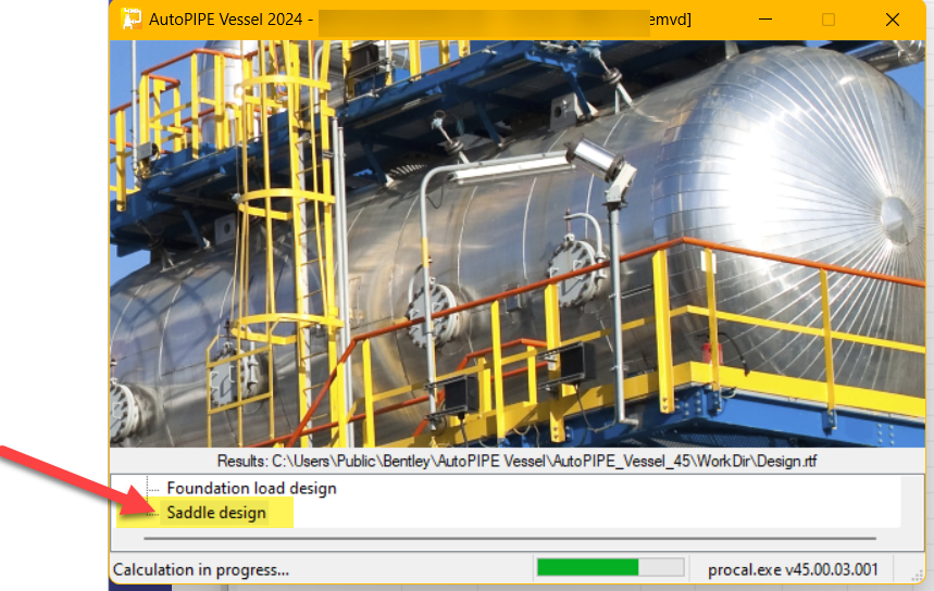

When Running Strength Calculations, the last calculation performed before message above appeared: Saddle Design
Take a moment, save the production model and save model as TEST, delete the saddles, and try to run Strength Calculations again.
What happens?
If calculations are completed, there is an obvious issue with the saddles, go back and review saddle information
If message above appears again, see next line.
At this point, again check the Vessel Properties, ensure all of the mandatory values have been entered. Also, confirm Liquid level is set not to a value between 0.00 to 25mm (ex. do not use 3.8mm, use 0.00 or value >25 mm). This issue was logged in Nov 2024 and will be fixed in future version (ref no. 1555475)

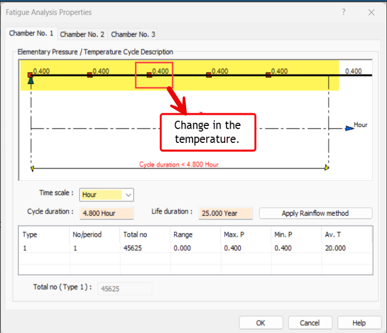

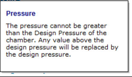

Suggestion #8:
The fatigue curve defined by the user appears to be inconsistent. Specifically, no change in pressure has been provided for Chamber 1, while a change in temperature value is present.
After modifying the pressure value of the first point to zero, the software was able to complete the analysis successfully.
Note, a change in temperature affects the calculation. The help section mentions that there is no limitation on the design temperature, unlike the pressure which is limited
This issue was logged in Oct 2025 and will be fixed in next version, AutoPIPE Vessel 47 and higher (ref no. 1766091).

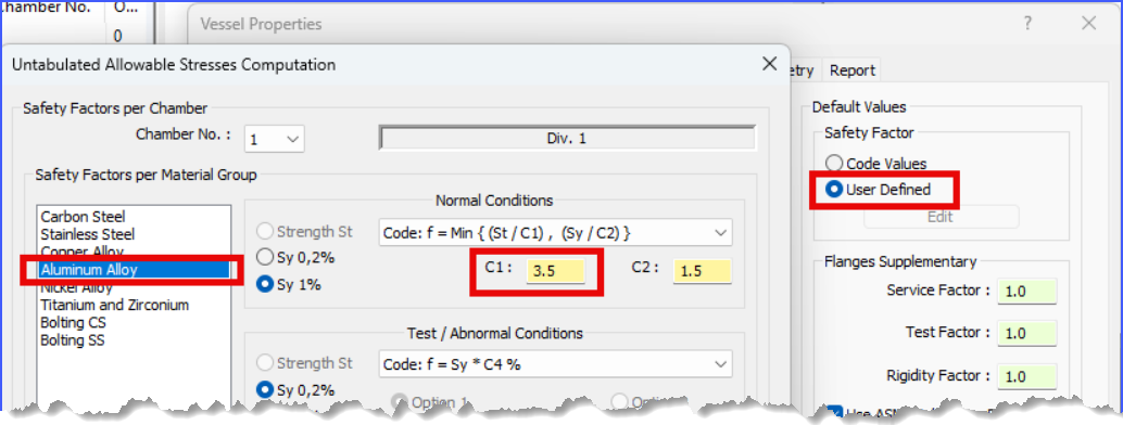

Suggestion #9:
Does the model have any component that uses a material that must have a Safety Factor defined for a code calculation?
If no, ignore this suggestion
If yes, in certain instances, performing a code calculations (for example, ASME VIII), a safety factor is not necessary. However, the model may be set up to perform an alternative code calculation on a different component that necessitates the specification of a materials' safety factor (for instance, verifying a bracket according to the AD 2000 S3 method). In these situations, it is imperative to define the materials' safety factor.
Workaround:
      1. Open Vessel Properties dialog.
      2. Select the "Design Conditions" tab.
      3. Select "User Defined" radio button, and press "Edit" button
      4. Input missing values: (example: C1: 3.5, C2: 1.5
