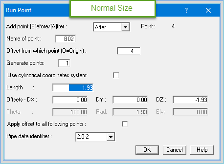

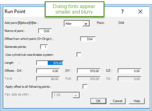

Dialog fonts appear smaller / larger, blurry, have line spacing issues when using AutoPIPE, why?
Why and how to fix it?

AutoPIPE has 2 different types of dialogs: Type 1 and Type 2
Type 1 dialog uses Font name = Courier New, Size = 8 pt (Modify Valve dialog)
Type 2 dialog uses Font name = MS Sans Serif, Size = 8 pt (Insert Run dialog)

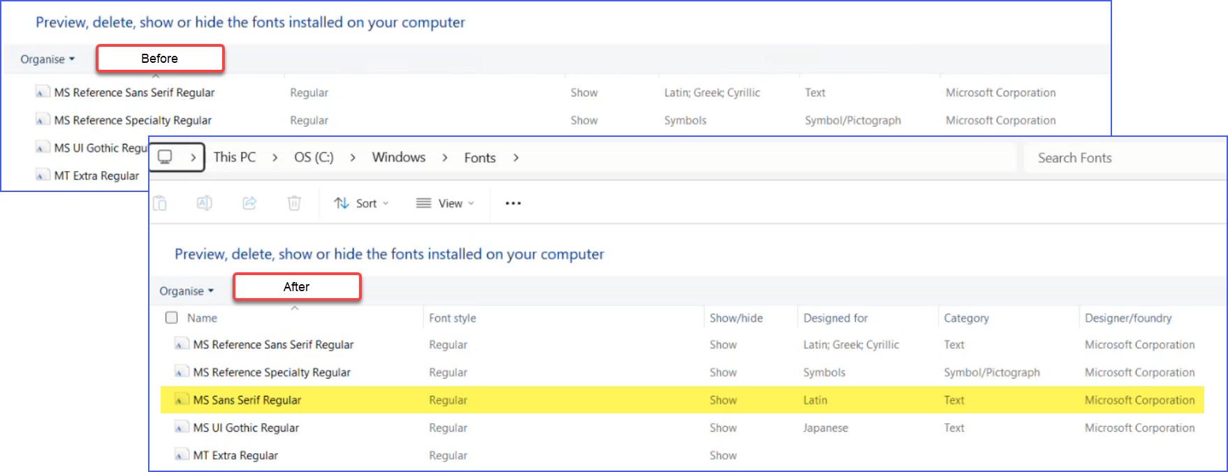

2. Have these font files been INSTALLED on computer?
a. Open Windows's "File Explorer" application
b. Navigate to the following folder: C:/ Windows/Fonts
c. Search for the following font files, all must be listed in the folder:
d. Are all of the font filles mentioned above listed in the C:/ Windows/Fonts folder?
If yes, skip to next step, "Windows Theme" below.
If No, work with your IT department to install any missing font files:
Example:

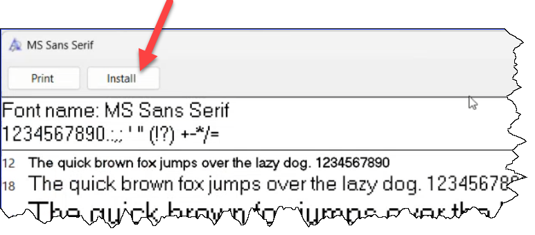

a. Open Window's Command Prompt
b. Assuming font file in on the computer, at command prompt type - "copy C:\Windows\Fonts\sserife.fon %temp%"
c. At command prompt type - "explorer %temp%"
d. When folder location opens, search for "sserife.fon

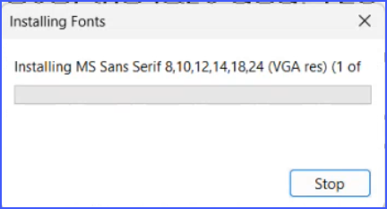

e. Double click the file to open the file for review:
f. Press Install button, the following should appear and then disappear:
g. Confirm new font appears in the Windows folder:

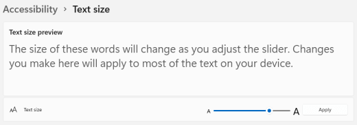

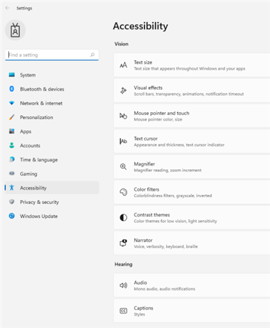

5. Windows Text Size
To go to the Accessibility settings on your computer, press the Windows logo key+U or select Start  > Settings  > Accessibility.
Select Text size.
Drag the Text size slider to the right to increase the size of the sample text.
Once you're happy with the text size, select Apply. Windows scales up the size of all text.

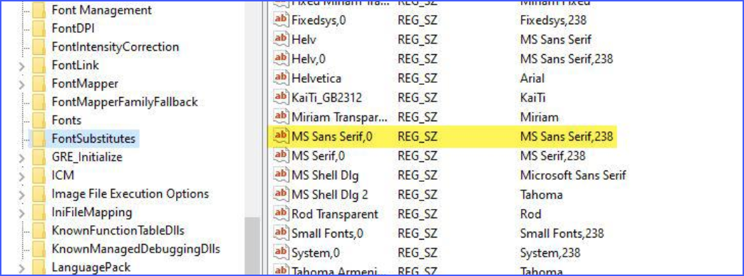

6. Delete the following list of font files from the computer:
a. Alibaba-PuHuiTi
b. MS Sans Serif,0
Example:
Open Regedit:
>Computer
> HKEY_LOCAL_MACHINE
> SOFTWARE
> Microsoft
> Windows NT
> CurrentVersion
> FontSubstitutes
> Delete "MS Sans Serif,0"
Then restart systems, and try to reproduce the issue

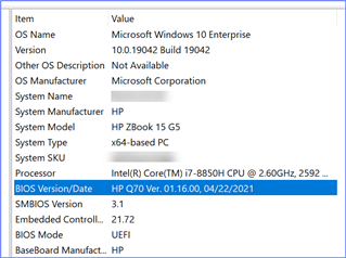

7. Update Bios on the computer
Check current Bios version.
1. Navigate to your computer's search bar at the bottom left of your home screen.
2. Search for "System Information"
3. Once you're in the System Information window, you'll be able to see a variety of information about your computer and its operating system, including BIOS version/date and BIOS mode. From here, you can take note of your software version to check if there are any updates to be made.
Update your Bios
This can be an intensive process, suggest that you contact your company IT department or perform a google search for detailed instructions.

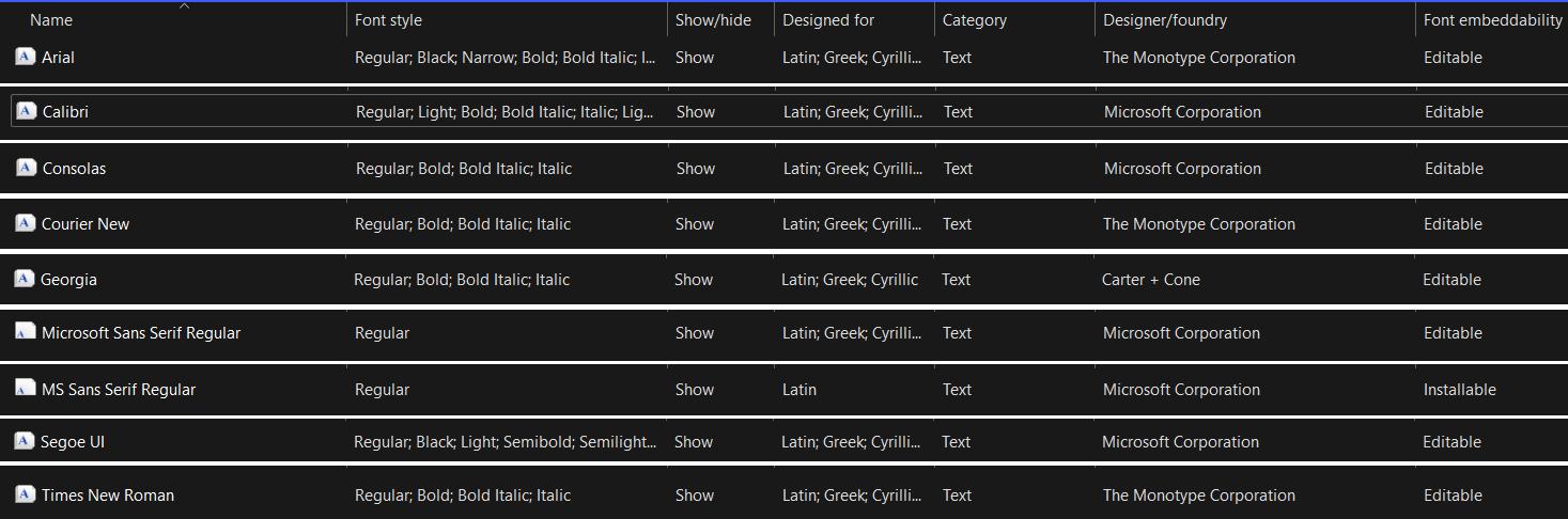

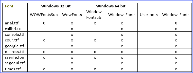

Search all of the files for each of the 9 fonts mentioned:
  1. UserFontList.txt
  2. WindowsFontList.txt
  3. Depending on Windows version:
"Font name"  -   "font file name"
  1. Arial  -   arial.ttf
  2. Calibri  -   calibri.ttf
  3. Consolas  -   consola.ttf
  4. Courier New   -   cour.ttf
  5. Georgia   -   georgia.ttf
  6. Microsoft Sans Serif   -   micross.ttf
  7. MS Sans Serif   -   sserife.fon
  8. Segoe UI   -   segoeui.ttf
  9. Times New Roman   -   times.ttf
The search results should match as indicated below:
Note, at a minimum all font files should be in the following locations:
Work with your company IT department to have missing fonts added and installed onto your computer.
