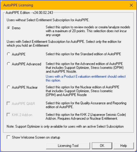

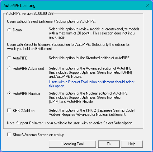

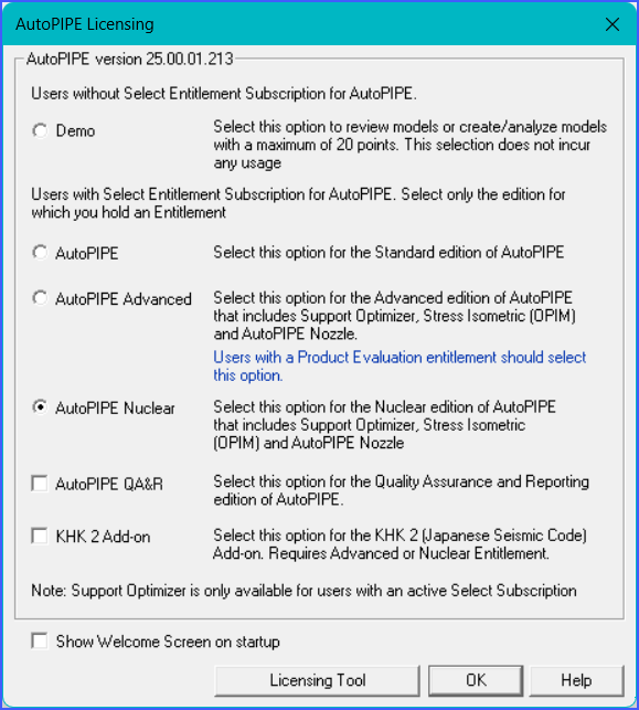

Q. Change AutoPIPE Edition License to: (Standard, Advanced, Nuclear)
Note:
a. User must be signed into CONNECTION Client before proceeding below, or have imported a license file with specific entitlements.
b. The same exact downloaded file is used by AutoPIPE Standard, Advanced, Nuclear, and all other language editions (such as Japanese, Polish, etc.). There's no need to download more than once. What functions and languages are available while using the software are determined by the license choice (ex. Standard, Advanced, or Nuclear) and program settings selection.
The AutoPIPE Licensing dialog  (which is also referred to as the Configuration dialog) will automatically display when AutoPIPE is launched for the first time after installation, or whenever the "Show Welcome Screen on startup" checkbox is checked in the lower left corner of the dialog. AutoPIPE will initially operate in Demo mode, The user is required to minimally select an edition setting (Standard, Advanced, or Nuclear) before continuing with their current work session. If it is not clear which option should be chosen, contact your company's Bentley On-site Administrator(s) for assistance.
Otherwise, use the procedure here to open the "AutoPIPE Licensing" dialog.
Questions:
a.  Features available when using an AutoPIPE Standard, Advanced, or Nuclear edition
- What is Demo mode?
b. Which edition to select on this dialog?
c. Which edition is currently being used?
d. How to download software?
e. How to review application release Notes?
Click OK to close the dialog an start using the program.

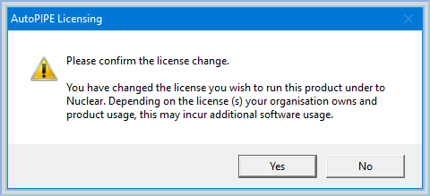

a. To help with QTL invoices, when using AutoPIPE 23 and higher, changing from one edition to another the first time will display the following warning message.
AutoPIPE Licensing
Please confirm the license change.
You have changed the license you wish to run this product under to
Nuclear. Depending on the license (s) your organisation owns and
product usage, this may incur additional software usage.
Yes No
Confirm available license in BLT.  There are no settings in AutoPIPE to limit licensing access to any edition of the software (Standard, Advance, or Nuclear); users must exercise restraint. Another options is for your company appointed Bentley On-Site Administrators to set up license alerting:

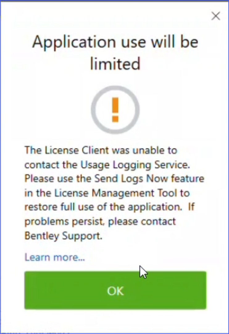

b. After changing the License edition, the following maybe displayed:
Click here for more details on this dialog.
