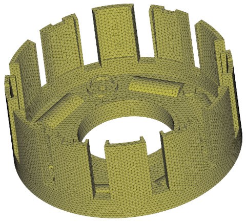

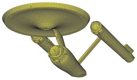

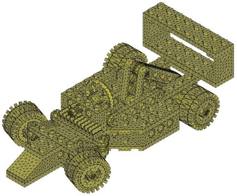

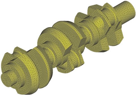

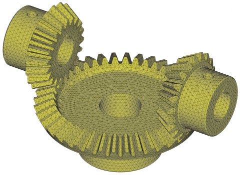

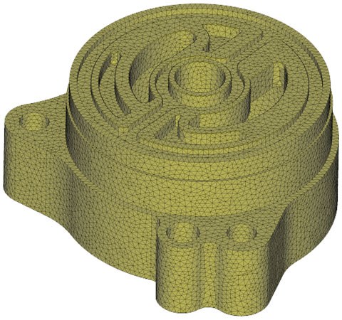

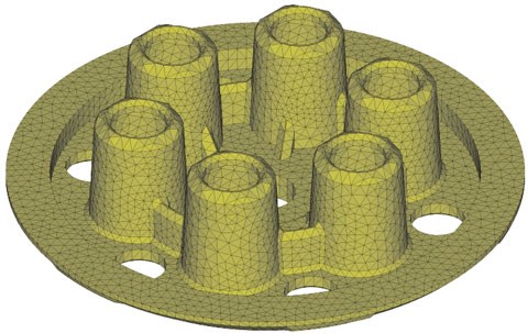

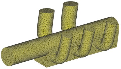

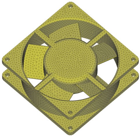

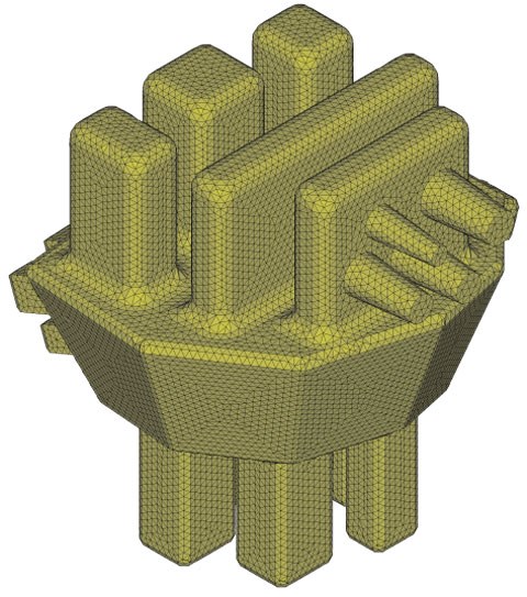

The following images show some meshes obtained with the Delaunay mesher.
Figure 1 Flow distributor
Figure 2 Structure
Figure 3 Outer basket
Figure 5 Mechanical part 1
Figure 6 Mechanical part 2
Figure 7 Mechanical part 3
Figure 8 Crankshaft
Figure 9 The Enterprise
Figure 10 Gears
Figure 11 Fan
Figure 12 Lego Formula 1
