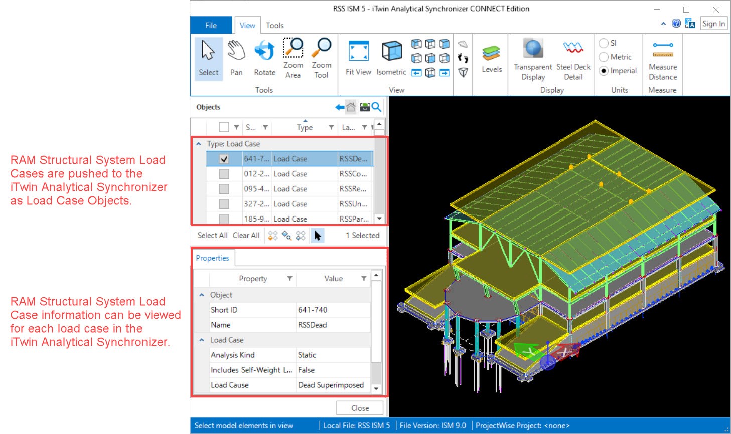

Load Case Objects
RAM Structural System load cases are pushed to the iTwin Analytical Synchronizer as Load Case objects.

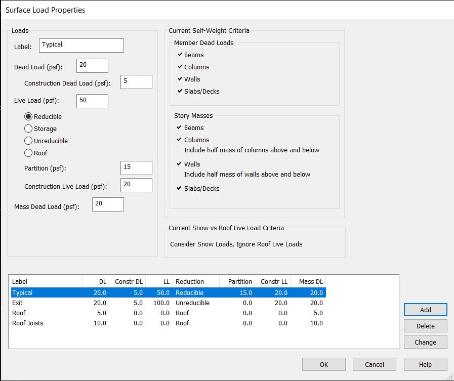

Loads Pushed from the RAM Modeler Property Tables
The RAM Structural System load case defined in the RAM Modeler Load Property Tables will be pushed to the iTwin Analytical Synchronizer.
RAM Structural System Load Case
iTAS Load Name
iTAS Load Cause
Dead Load
RSSDead
Dead Superimposed
Construction Dead Load
RSSConstructionDead
Dead Construction
Reducible Live Load
RSSReducibleLive
Floor Unspecified
Unreducible Live Load
RSSUnreducibleLive
Floor Assembly
Partition Load
RSSPartition
Floor Office
Construction Live Load
RSSConstructionLive
Floor Construction
Constant Snow Load
RSSSnow
Roof Snow Uniform
Drift Snow Load
RSSSnowDrift
Roof Snow Drift
Mass Dead Load
RSSMassDead
Seismic Ultimate

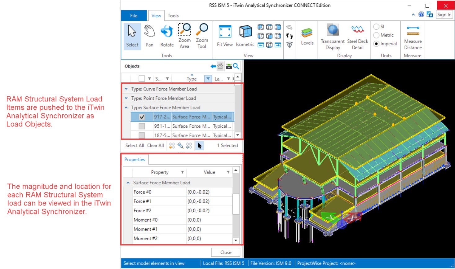

The Surface Loads, Line Loads, Point Loads, and Snow Loads defined in the RAM Manager Load Property Tables will be pushed to the iTwin Analytical Synchronizer as Load Objects.

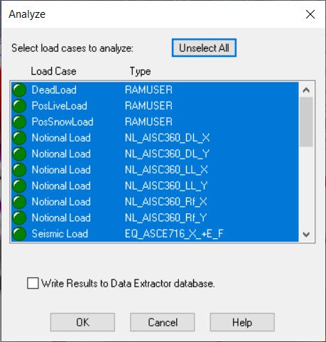

Load Pushed from the RAM Frame Analysis
The RAM Structural System load cases included in the RAM Frame Analysis will be pushed to the iTwin Analytical Synchronizer as load case objects.

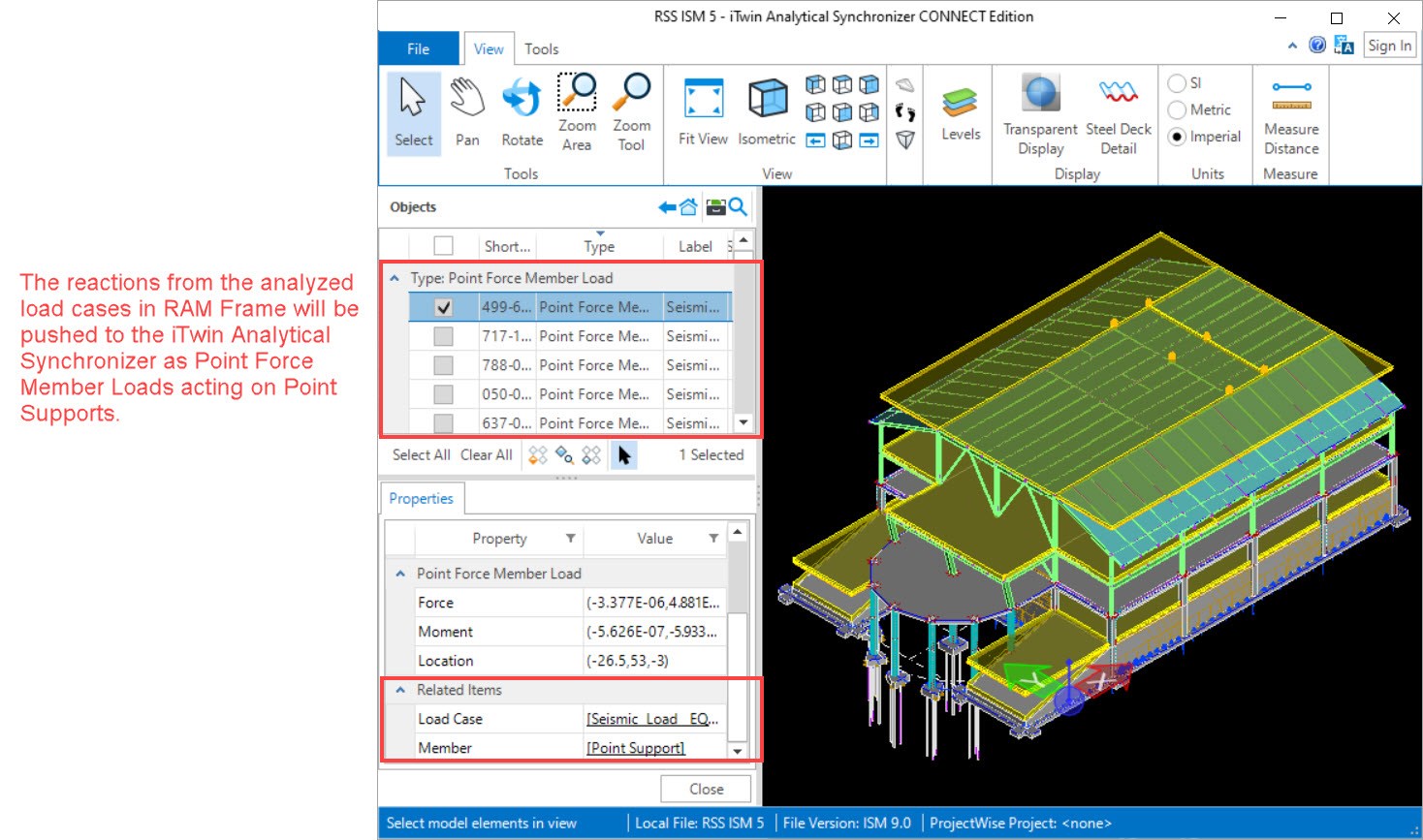

The story forces for each RAM Frame analyzed load case will not be pushed the iTwin Analytical Synchronizer, but the resulting reactions from each analyzed load case will be pushed to the iTwin Analytical Synchronizer as Point Force Member Loads acting on Point Supports.
