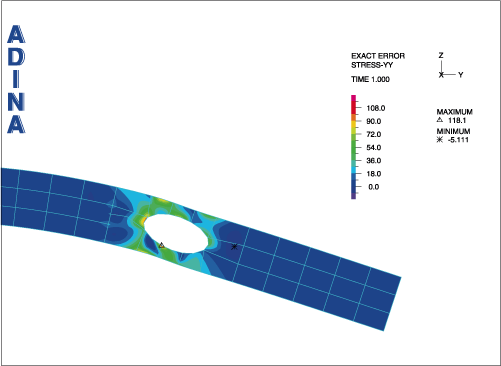

The figures below show results obtained in the study of a cantilever structure with the left end fixed, in linear, nonlinear and FSI solutions. Of particular interest is the stress solution around the elliptical hole in the middle of the cantilever. In the linear analysis, the structure is simply subjected to the uniform pressure p. In the nonlinear analysis, this pressure is increased to 6p and causes plasticity and large deformations. Finally, in the fully coupled FSI solution, the steady-state force effects of a Navier-Stokes fluid flow around the structure (of magnitude about 2p) are considered in addition to the pressure of 6p.
In each case, a coarse mesh ADINA solution, the ADINA error estimation for the longitudinal (bending) stress using the coarse mesh and the "exact" error are shown. The exact errors have been obtained by comparing the coarse mesh solutions with extremely fine mesh solutions (that in practice would of course not be computed). The ADINA error estimation is seen in these cases to be conservative and not far from the exact error.

Figure 4(b) Cantilever structure — FSI analysis,
exact error in region of interest shown
