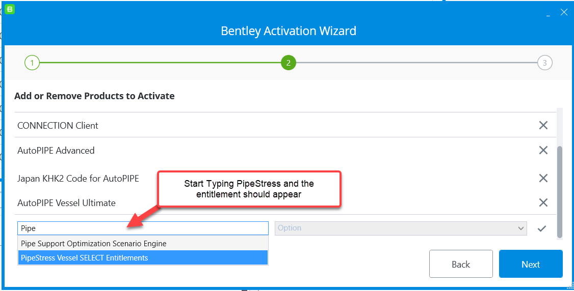

There is a special entitlement license named “PipeStress Vessel SELECT Entitlements” which is available free for anyone with valid SELECT Entitlement.
For any user having a license problem, confirm the following:
1. Open the "Welcome to AutoPIPE Licensing" dialog, and confirm that either AutoPIPE Advanced or AutoPIPE Nuclear license has been selected.
2. Open BLT and confirm whether “PipeStress Vessel SELECT Entitlements” is listed. On the Entitlements tab, Checkout License tab.
If "PipeStress Vessel SELECT Entitlements" is not listed then perform one or more of the following:
a. With computer connected to the internet, log into Connection Client, start AutoPIPE, open the "Welcome to AutoPIPE Licensing" dialog, and confirm that either AutoPIPE Advanced or Nuclear license has been selected. Then use Support Optimizer command. After submitting a job for analysis, the "PipeStress Vessel SELECT Entitlements" should now be available in BLT.
b. Use Activate Product command to try and activate the product.
C. Work with your Bentley Onsite admin to help address the issue.
Remember after making changes in BLT, use Tools> Refresh Policy to see updates.
