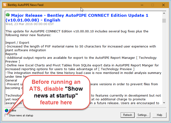

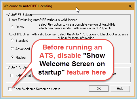

2. Before running an ATS, highly suggested to disable the following features:
a. Show Welcome screen
Open Welcome to AutoPIPE dialog (File > License > Configuration) and uncheck box at the bottom left corner.

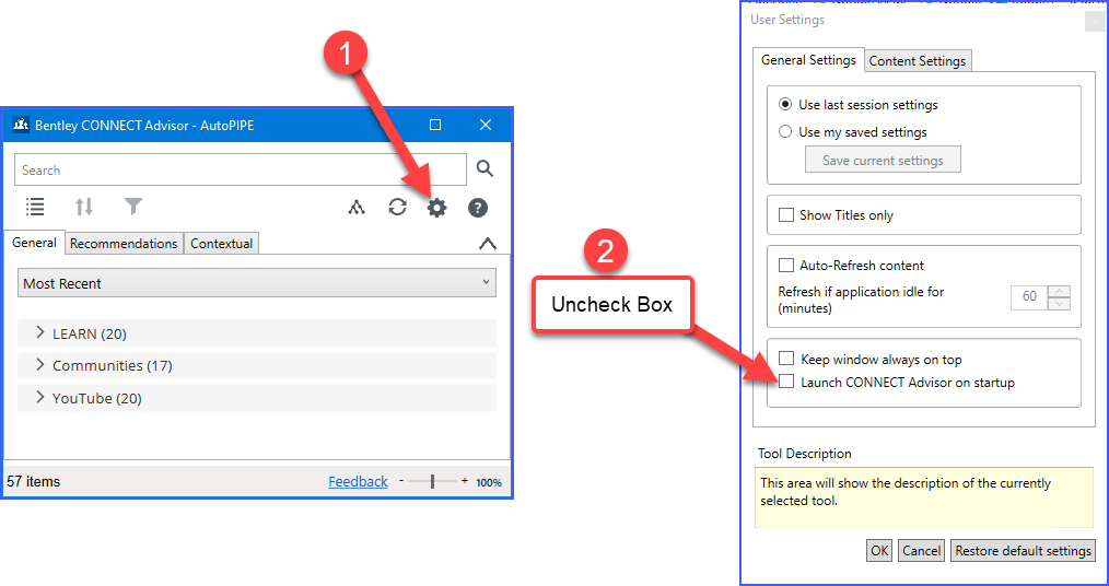

b.  CONNECT Advisor (AutoPIPE 11.01 to 12.04.).
Stop Connect Advisor from starting with AutoPIPE
Or
If available, Turn off **RSS news-feed
open news feed dialog and uncheck box at the bottom left corner.

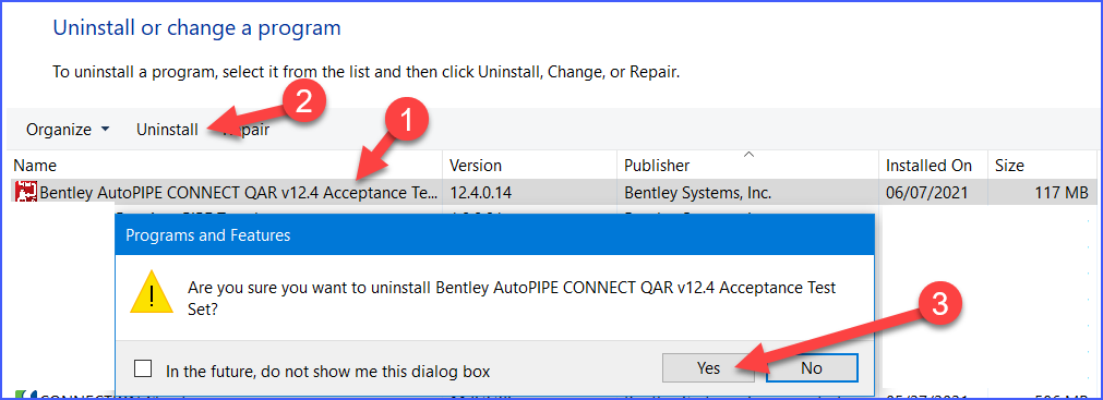

C. How to Uninstall an AutoPIPE ATS
Windows has feature to assist users with installing / removing applications, open that feature now:
After starting said feature, follow the proper steps required to uninstall the currently installed ATS application.
Example:
After the application has been uninstalled, locate and manually remove the ATS installation folder as mentioned in readme file / release notes.
