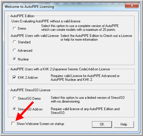

2. Start AutoPIPE
3. Select File> License Configuration
4. Select the version of AutoPIPE (Standard, Advanced, or Nuclear)  that you have a valid license for in LMT (License Management Tool) to be used while running the ATS. Warning - different versions of AutoPIPE will run a different sets of models during the ATS.
5. At the bottom of the License Configuration, uncheck "Show Welcome Screen on Start Up"
6. Press OK button.

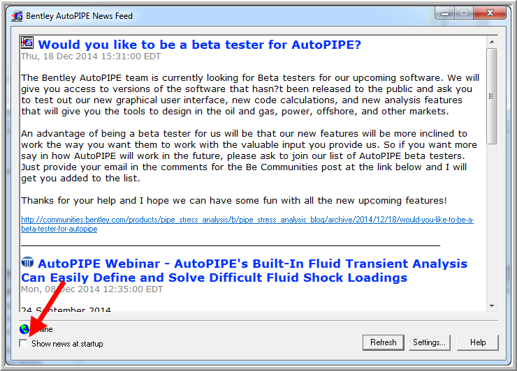

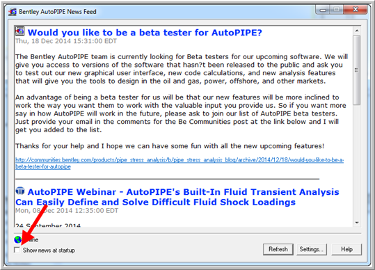

7. Select Help> AutoPIPE News..
8. At the bottom of the dialog, uncheck "Show news at startup".
9. Press OK button to close dialog
10. Run AutoPIPE ATS as needed.
