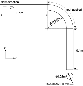

Our objective in this News is to illustrate these capabilities, by solving the pipe problem depicted in the above schematic, showing the geometry and boundary conditions.
Hot fluid flows through the flexible pipe, which is therefore heated by the fluid and loaded by the fluid tractions. The temperatures, deformations and stresses in the pipe, together with the fluid flow and fluid temperature need be solved for. The fluid is modeled using FCBI-C elements and the structure is modeled using MITC9 shell elements.

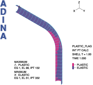

Figure 3  Solid Mesh with Magnified Deformation and Plot of the Thermal Strain
Figure 4  Effective Stress Plot and Temperature Plot
Figure 5  Plastic Flag Plot and Accumulated Effective Plastic Strain Plot
