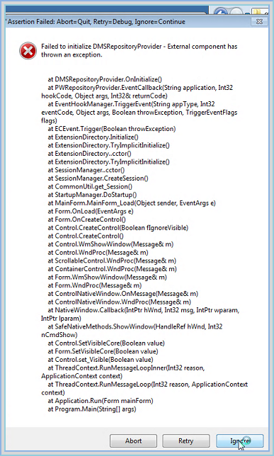

Following dialog may appears when trying to open OPIM:
Warning:
Error adding path...
Illegal characters in path
OK
Or
Failed to initialize DMSRepositoryProvider - External component has thrown an exception
Why and how to avoid?

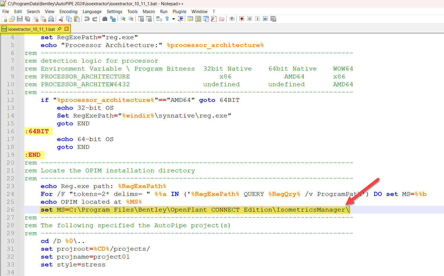

Answer:  Iso extractor path name was missing from bat script.
Workaround: OPIM Version 10.11.01.XX and 10.11.02.XX
Step #1: Close AutoPIPE
Step #2: Open the following file: "isoextractor_10_11_1.bat " from folder location -
C:\ProgramData\Bentley\AutoPIPE 2024\isoextractor
Step #3: Locate "echo OPIM located at %MS%" in file.
Step #4: On next line below add the following information:
set MS=C:\Program Files\Bentley\OpenPlant CONNECT Edition\IsometricsManager\
Note: may need to confirm that "OpenPlantIsoExtractor.exe" is located in path above, if not adjust path above as needed.
Step #5: Save Bat file and close
Step #6: Start AutoPIPE and create a Stress Isometric, DWG or DGN file should now be created in folder location

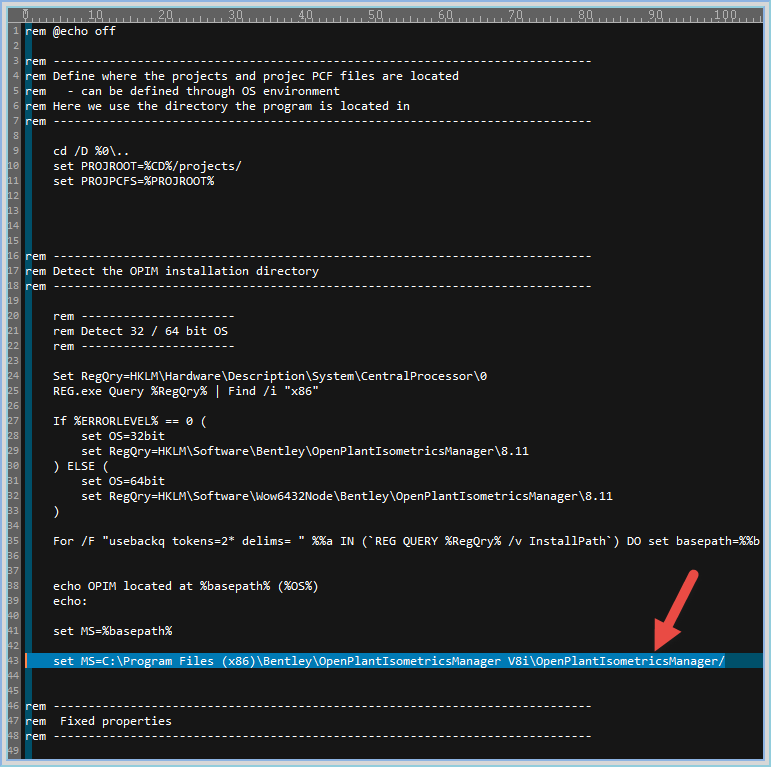

Workaround:
OPIM Version Below 10.5.XX.XX
Step #2: Open the following file: "isoextractor.bat" from folder location -
C:\ Program Files (x86)\ Bentley\ AutoPIPE CONNECT v11\ isoextractor
Step #3: Locate "set MS=%basepath%" in file.
set MS=C:\Program Files (x86)\Bentley\OpenPlantIsometricsManager V8i\OpenPlantIsometricsManager/
