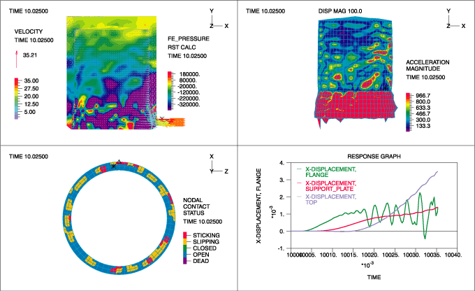

A test finite element analysis was set up to perform studies and to obtain some insights, see Figure 1.
The model consists of an elastic shell fully clamped at its base and a fluid surrounding it which is contained by an exterior rigid wall. The MITC4 shell elements and subsonic potential based fluid elements are used to represent the media. The shell structure consists of two pieces with frictional contact conditions between them. The model is subjected to a sudden fluid flux representing a pipe break. The resulting shock waves cause the internal parts of the model that are in contact to rapidly change status. For the implicit dynamic analysis of such problems usually the Newmark time integration is used. However, when contact conditions are included between internal parts, the contact surfaces repeatedly stick and slip, which results in rapid pressure pulses in the fluid. Due to the coupling to the structure, high frequency vibrations of the walls are also observed (see the top right movie). These high frequency oscillations are spurious in the Newmark method solution and grow with time. After a while the solution becomes obviously very erroneous and may even diverge. The results using the Newmark method without damping are shown in Figure 2. Note the highly oscillatory response of the flange, the non-smooth contact status between the internal parts and also the parasitic pressure distributions in both the solid and fluid phases.

Figures 3 to 5 depict the response of the system using the different time integration techniques mentioned above and always the same time step size:
Figure 2  Newmark method, no damping (δ = 0.5, α = 0.25)
Figure 3  Newmark method with Rayleigh damping, with C = 0.001K
Figure 4  Newmark method with numerical damping, (δ = 0.6, α = 0.3025)
Figure 5  Bathe method, no physical damping
Considering the above case studies, it is observed that while the presence of physical damping or numerical damping improves the results using the Newmark method, to suppress all oscillations, the damping must be increased to high levels, which is not desirable. However, when the Bathe method was used, a significant improvement was found. Note that in this case no numerical parameter had to be adjusted and no artificial physical damping was introduced in the model.
